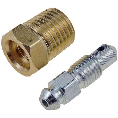

You mean the caliper bleeder? No  but i just got off the phone with auto zone. I ordered a repair kit. My fork leg had some brake fluid on it today so the caliper needs a rebuild. I hope the repair kit works. Otherwise i guess ill just keep looking for a new caliper. I would prefer a new caliper.

ffJMoore: Yes, I meant caliper not master cylinder. That picture you posted is of the same kit that I used on my caliper and it worked out great. Good luck.

replaced the bleeder. So far so good. Anybody that needs it done, Ill do it for $10 plus return shipping. I also did a write up in the TECH section if you want to do it yourself.
