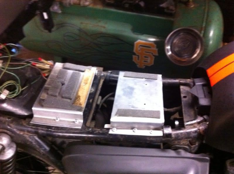

I think it's gonna depend on seat material/quality... And the weight of the rider... With a fiberglass seat sitting on 4 posts is gonna put a lot of stress on four small spots. What I did was use 2 pieces of aluminum 4" wide bent to act like a raised platform and attached with a couple of tek screws to the frame. Add a couple pieces of foam rubber, and 3 more tek screws to attach the seat to the aluminum and viola. Oh, I did Velcro the seat pad to the seat though... A must if ya wanna get the seat off...
As you can see I #$%*ed up the rear most platform and it's currently shimmed till I make another... But about 4k miles and no problems...

AH I think this is what Stev-o was stating.... How high is the fold? Where did you get the aluminum? I was thinking of using the industrial velcro for the seat pad to the actual ABS seat I have.
I can't remember the exact measurements... Something like 1/2" in the front and 3/4 in the back. But it gonna depend on the shape of the seat. My seat (carpys rocket four) is sloped front to back and slightly domed side to side. I used the industrial Velcro and it works great for the pad. But my pad is as hillbilly as it gets. Soon it'll get swapped for a button on cover, when I can afford to have one made...
The aluminum came in 12"x4" sheets at ace. I just grabbed two of the thickest and bent em with my vice and a rubber mallet

Thanks for the info, I will hit up Ace tomorrow. They know me by now as I keep going for little stuff here and there.
