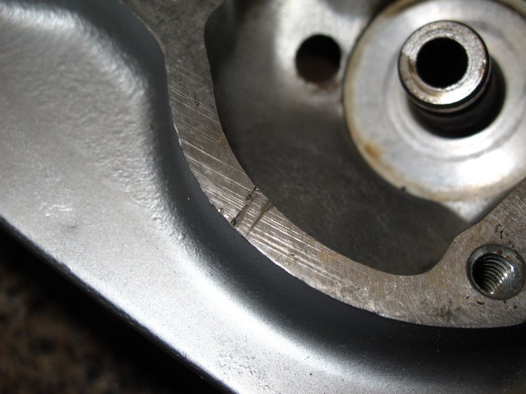

Started to reassemble my 750 head and put a nick in the top sealing edge with the valve compressor tool.
Should I worry about this?
If I clean up the burr's will the gasket seal this?
Should I fill the nick with JBweld?
Thanks for any suggestions.

clean it lightly with a fine file.

As dave sez and if a groove still there use a TINY amount of RTV

Thanks, will do!
