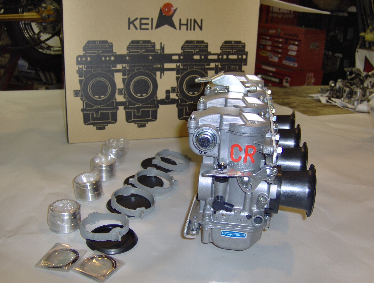

Additionally, I bought four carb kits from the same whimsical ebay vendor for a maddeningly cheap $20!!!
The kit seems suitable from my amateur perspective.  It even comes with 3 different main jet sizes.  The only things that it does not come with that I had to locate; the o-rings that go on the metal T's where fuel comes in between 1-2 & 3-4, and float bowl gaskets.

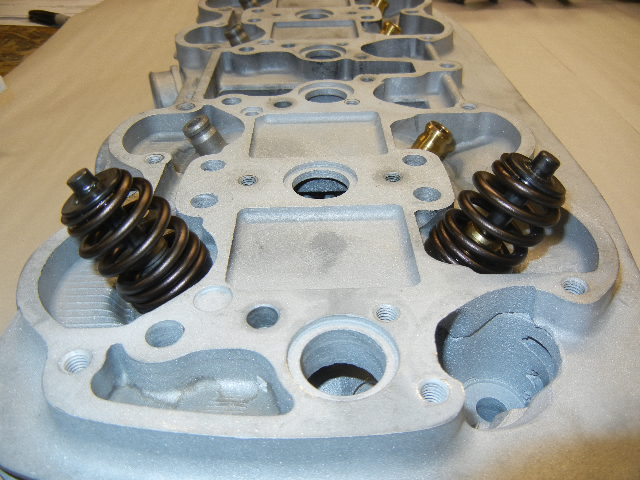

I tried to do some mild deshrouding and cleaning up of the combustion chambers-
I did polish them for fun, I figure that should be good for at least 10 extra hp  ;)   I also checked the head gasket surfaces and discovered that the cylinder head is off by about 1-2 thousandths.  Since I am going to use MLS gaskets this will need to be resurfaced flat  >:(

I ordered what should be the last of parts needed for this build today.  When I was getting measurements on the motor I noticed a few valleys on the bottom of the cylinder head and top of the cylinders.  After checking around to see what shops wanted to flatten these parts I decided I'd just do it myself!
As a result, out came a piece of glass, spray adhesive, and some sandpaper-
Starting with 150 grit, you can start to see the valleys as the surfaces that aren't hitting the sandpaper-
After awhile they get less visible-
Eventually the entire surface looks consistent (you can see where I draw on the surface with marker just to see that I'm hitting everything evenly)-
Once, I got things flat I moved to 400 grit and oil-
That got things pretty smooth-
Then, lastly, I used 600 grit and oil and things were looking real smooth  8) -
