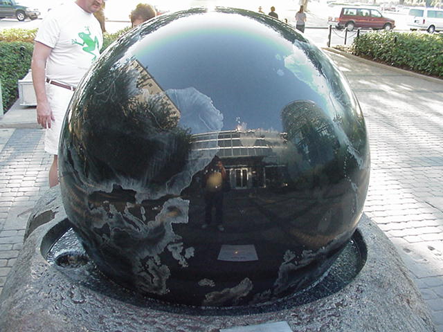

The Natural science museum in Houston has a Kugel Ball sculpture right outside.
Explained here:https://en.wikipedia.org/wiki/Kugel_ball
These things have a large pump, I think 5 or 6HP. And the gap between the ball and the cradle is thinner than a credit card.
This is the same principle as in our engines or the turbines in hoover dam.
They are fun to play with :o :o :o
Steve
