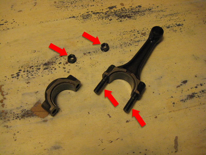

I have read that is is a good idea (good practice) to replace the connecting rod nut and bolts when doing an engine rebuild:
Is this really necessary ??? Is it not enough to simply add some loctite red and be done with it ?!? Can anyone shed some light on this ? as if it is reccomeneded I should get some connecting rod bolts orders :)
Cheers,
Jon.
Offline somesuch
  • Posts: 287
Re: 750 DOHC Project
« Reply #72 on: May 10, 2012, 10:53:41 PM »
It depends on many variables like RPM that the engine will see, the type of bolts, piston weight, etc., but to make the long story short, I have reused bolts/nuts on a stock 82 800F motor that lasted at least 30K after I rebuilt it (maybe more, but I lost track of the bike) .... that said the 750 is a higher revving motor.
@somesuch - I checked the book and spec and taken into account with the milage of the motor and previos state, it basically headed towards replacing them, on closer. After further investigation I have decided to played it safe and ordered some new nuts and bolts. Thanks again !!!

This will be the back of my seat unit. The original was (unfortunately) hacked off by the previos owner :( although I think this will look good:
So parts are slowly but surely starting to arrive:
Primary chain and tensioners:
These must be the most expensive nuts and bolts i've ever bought (connecting rod nut and bold set):
