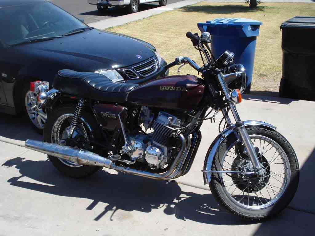

  I have always wanted a cb750 and got lucky the other day and picked up a non running 78 for $350  all parts are there and looks great!
I'll upload some pics later today as i have not taken any yet!
  Got it runing today after tearing the carbs down and cleaning the snot out of them but the bowels are leaking and nobody in town sotcks floats or needles...  My floats are all craked up and need replaced.

Your bike has an accelerator pump to squirt fuel into the carbs when he throttle is opened.  Engine pickup is much better when this works.  Look at the bottom of #2 carb.  There are also two check valves that must function for that pump.  And, the squirt nozzles in each carb must be clear.
It look like someone has grafted a 75 or 76 F model exhaust onto your bike where there was a 4 into 4 before.  The extra bulk of the pipes is what is blocking you brake pedal.
You might look into getting an F model brake lever.  Or, get some after-market pipes that are designed to clear the original brake lever.
