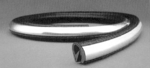

To fasten the seat cover to the seat pan, I ordered this trim that I found from http://www.siriusconinc.com/ .
http://www.siriusconinc.com/pro_detail-chrome_seat_trim_band-36-2726.htm
It looks very similar to the original seat trim, which as we all know, is pretty much impossible to replace as original because it is molded directly into the seat cover.

The chrome trim was very nice and thick. It's got some weight to it, as well and it is of a u-channel design. Be careful, though. You need to tug on it a bit because they don't give you any excess. Only enough to do one seat, so you gotta stretch on it a bit.
