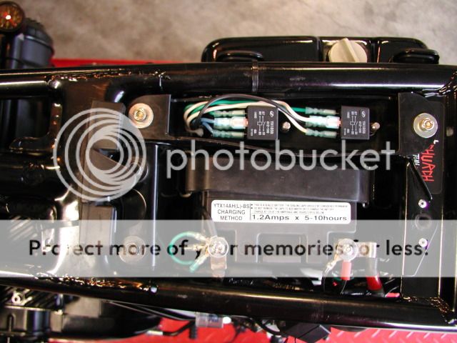

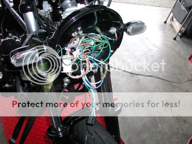

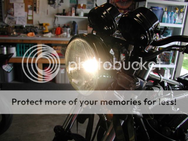

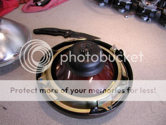

So today I got my Bosch Motorcycle H4 conversion finished. I ended up using two relays and used the diagram Steve F posted in another thread. I mounted the relays in my tool tray and routed the wires in front of my battery. I ran power and ground directly from the battery. I installed a fuse in the unused space in my blade fuse holder. I also cleaned up my wiring and finally got around to making mount brackets for my fuse box and reg/rec. The Bosch fits in my aftermarket bucket PERFECT. The conversion does take up a bit more room and sits deeper in the bucket than the old sealed beam. Its WAY brighter! I can't wait to test it out at night.

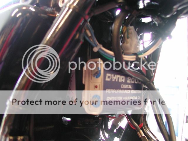

Nice , clean wiring . I ordered the housings from Skylightguy . Just waiting for them to arrive . Do you think you could fit the relays in the bucket with the beam ? Id rather have them there . I want to run a new fused feed from the battery to the bucket for the relays and put a relay under the tank for the coils as well (3Ω Dyna) to save the kill and key switch .

« Reply #30 on: June 02, 2012, 04:08:36 PM »
I could probably have stuffed them in there but it would have been TIGHT. I would not have been satisfied. I had to carefully burrow a space in the center of my wiring for the reflector to nestle into. If you have a bigger bucket than I do it would be a better fit.
