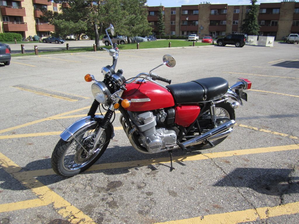

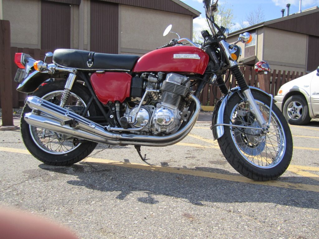

Ok guys, here is the update... I took off the afternoon from work "sick" ... (it was slow anyway). lol On the ride home it started running #$%*ty again like I had a plugged idle jet... so I tore into it.
Here is what I accomplished:
-Tore down airbox & carbs
-inspected float level... adjust one slightly
-cleaned out all needle seats (found some crud in the one that was leaking)
-checked the pilot jets ... one of them may have been plugged already?
-moved needle clip from 3rd to 4th from the top
-reassembled everything and took it for a spin
That tear down, inspection, reassembly only took about 2 hours. Then I went for a rip .... bog is pretty much eliminated! She's alive! There is a couple places in the rev range if you jam the throttle wide open it will cough for a split second and then go but I think that is just the nature of running non-cv carbs.
Then I brought her back when she was all warmed up and hooked up my sync gauges. Got the sync pretty much spot on and took it for a rip again.
The throttle response stayed about the same but the low rpm idle smoothed out some. I can idle it down to 1000-1100 now if I want to where I couldn't get it to idle that low reliably before. Nice!
I also fueled her up and washed her.... here are some pics and a vid right after the wash as I parked her.
Hopefully those pics work!
I'm pretty stoked she runs real nice now. Woo!!!!
