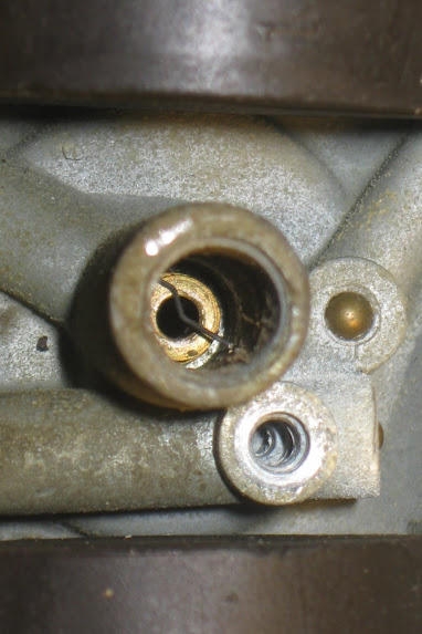

Clean the port in the air intake side of the carburetor.  I have a K6 and HondaMan recommended I do this to resolve my "sooty plugs".  It did the trick.  I don't recall if I had 105's or 110's at the time.  I was largely stock then except for a 4-1 exhaust.  Here's a picture of an "E" string (I think) from a guitar with a "jog" bent into it to help clean the crap out of the port (rotate the wire to scrape the crud from the opening at the jet holder base).  The area you are really trying to clean is at the base of jet carrier "hole".  A small percentage of restriction here will cause sooty plugs.  See pictures below:

« Reply #16 on: June 07, 2012, 02:48:25 AM »
Thanks i am going to do this before i refit the carbs.
