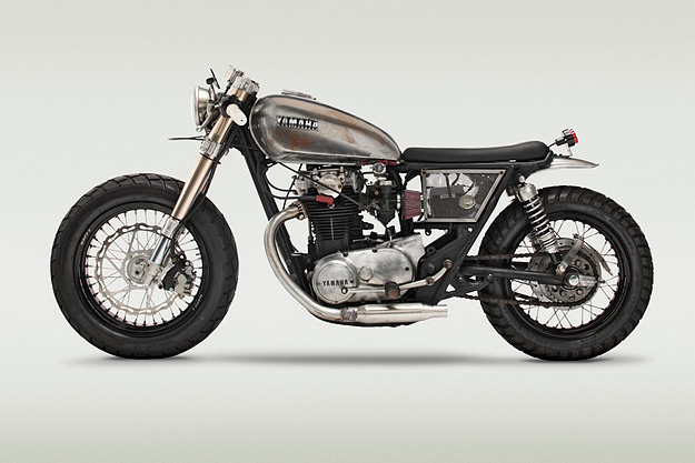

The plan is to run without the stock sidecovers, I'm going to make somewhat of a compartment in the triangle area to put stuff in like my wallet, keys, phone, a little toolkit I'll put together, and a baseball cap to keep the helmet hair under check. I'm going to make mesh style sidecovers from scratch for the sides in the triangle portions to dress things up
for the sidecovers I want to do something like this:
