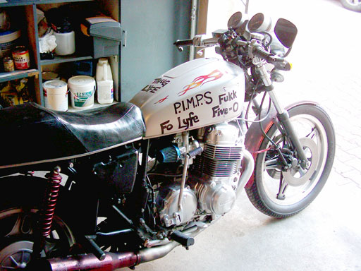

I just got my new Rat K8 delivered to my house. I'm scratching my head right now...
Bike was in posesion of this kid, who painted (almost) everything with rattlecan silver paint. Engine, carbs, wires, pipes, partially frame, overspray on instruments...
Pod filters are painted blue, shocks red... you get the picture.
 Acetone did a trick on controls, but may be to harsh for carbs and wires.
How do I go about safely removing this paint. Aircraft paint stripper (brand?), sand paper or something different altogether?
Check it out (don't laugh, please)      :D

No reply on the issue, but would like to say "PIMPS FO LIFE"!!!!!   ::)

                 Aside from the paint, it looks like you've gotten a pretty decent bike to work on though.
          I'm sure you'll do good by it and we're glad for you. We're also anxious to see what you're
          going to do with it. There are plenty of good ideas and examples here on the site for you to
          go through. Good luck and I'll check you later on, Bill

I'm not riding it yet. First thing I did when the bike "arrived" in the back of the pickup truck, laying on it's side, was to remove the tank. That picture doesn't show all the "details". Anyway, it's completely rusted on the inside...
