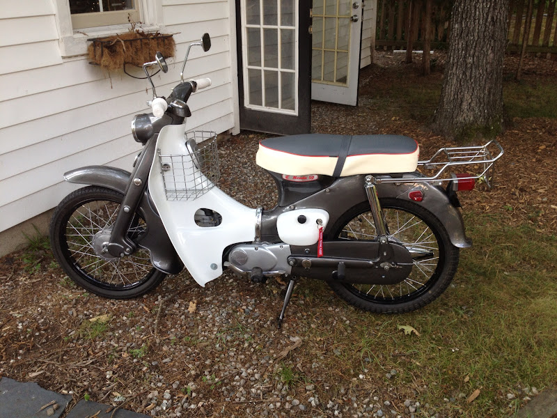

So the beer runner is finished short of a wooden crate to hold the beer...
