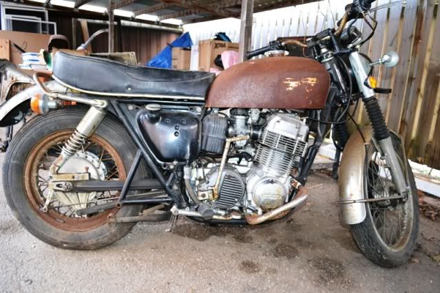

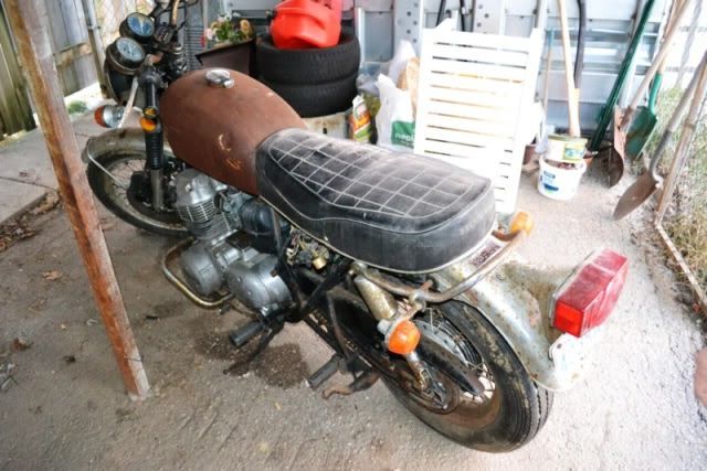

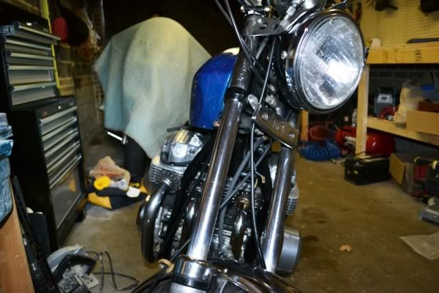

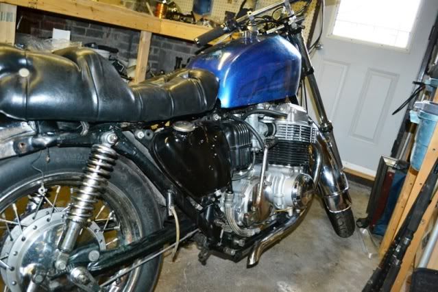

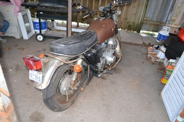

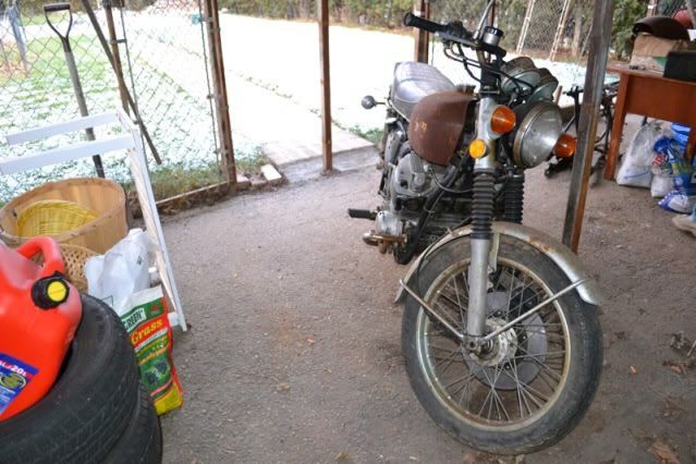

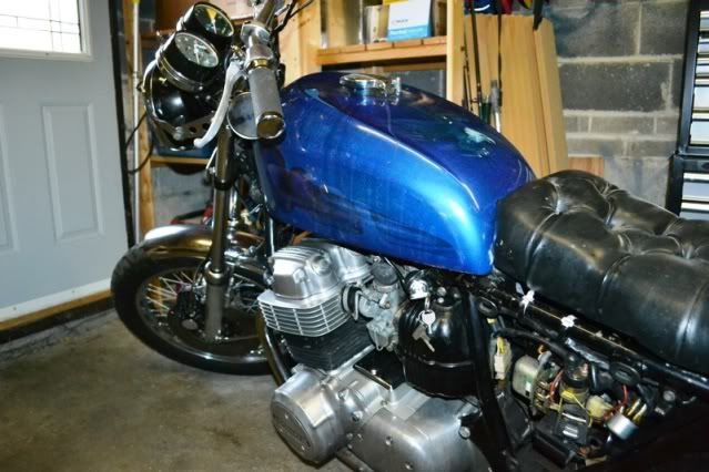

Ok here we go ,last year I bought three Hondas CB 750 .
First one 1971, look like Chooper can start try and needs a carbs job I think so .
 Only 32 000 K have a side covers .

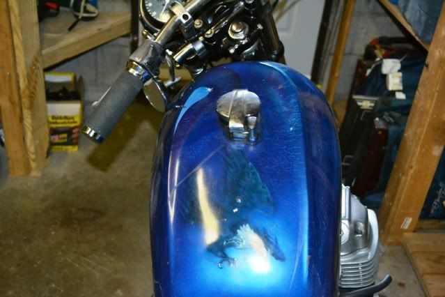

Look at this cooooool paint job .Guy who painted is not kicking around any more ,sad ! >:(

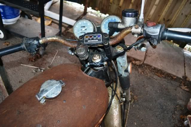

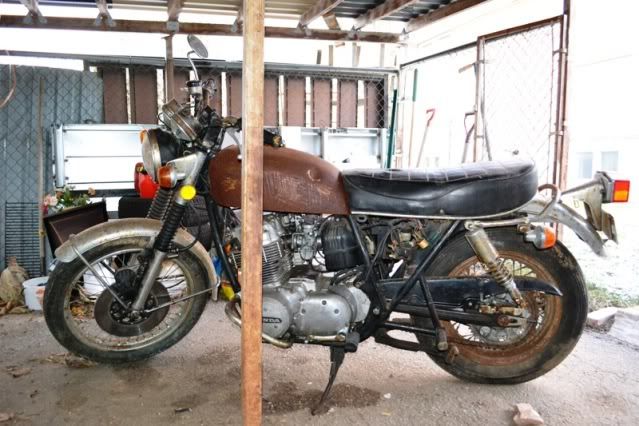

Second one 1972 seized engine all rusty it was sitting in somebody shed that was leaking roof for a years .
I bought them all from one guy from Berriie Ontario .very ruff condition but everything on it except left side cover :

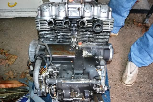

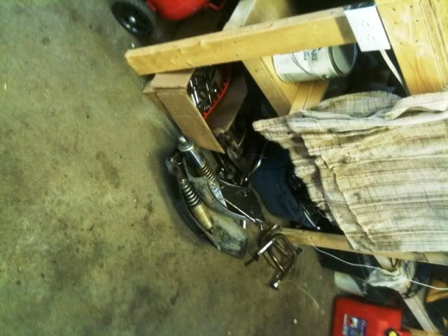

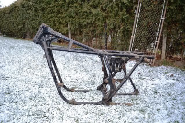

And finally a third one 1975  in a pieces guy try to restore it and gave up.
Frame and motor and bunch of boxes with screws,nuts, different fenders and wheels and ect.
Motor is seized ,try to turn not working ,but who cares i'am gona do it from scrap if I could hopefully with your help guys!

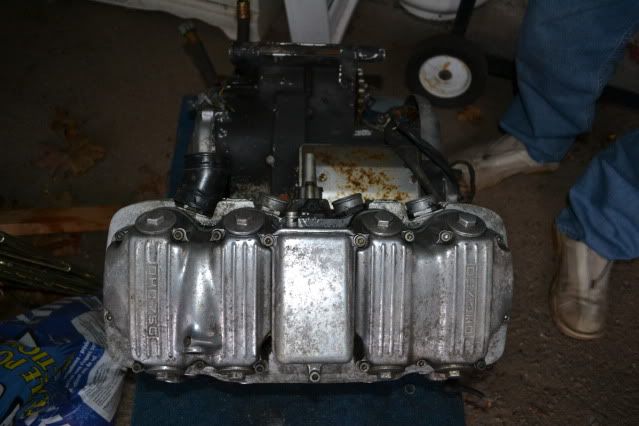

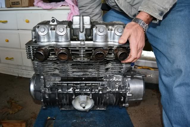

I  took apart hole bike ,started working on engine.Before that red lots of this forum to see am I able to do it.Have a faith that  you guys going to help me with this .Engine was seized wasn't any chance that it could move it.Try everything !
After I took apart engine,  sow that  on the camshaft and camshaft holder  one of the bearing surfaces  badly weared .That is first one after sprocket
I'll post a picture  .
So I am wondering can I used one from same bike year 1975 to replace it and camshaft and holder  or just go and by new cam like  ( Dynoman ) or somrething else and holder ?
 1 . Some of my budies that are in Harley advice me to go with little bit more aggressive cam ,no anything like 836 or 915 just something to freshen up the engine ?
2 . What do you think about that ,but then I should go with different valves and springs to should  I ?
3 Also in manual said that you must change a valve seats !
I will appreciate your input

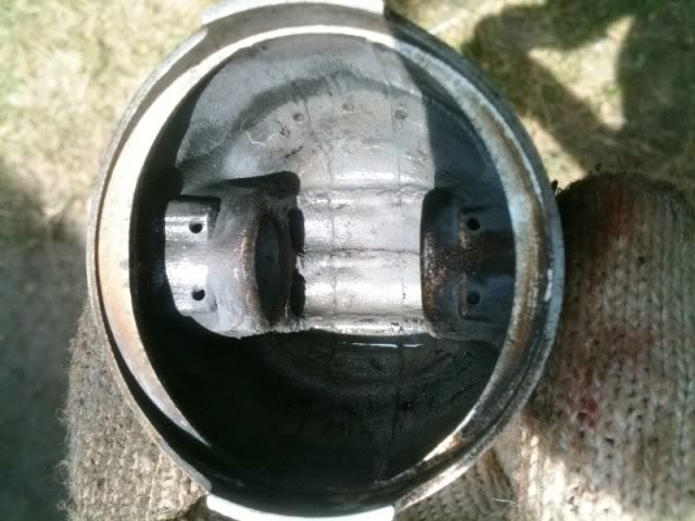

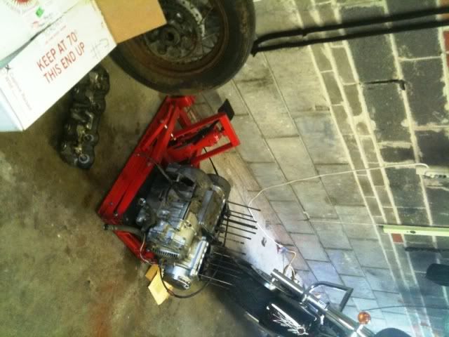

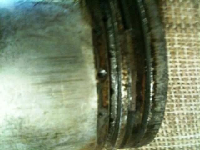

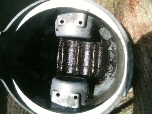

After I took of cylinder head  I discovered that last on the left piston rod is also stuck ,actually the first one from the bottom on the picture,most shiniest one .
Three of them moving freely and that one is not moving.When u push that one it's moving  the hole crankshaft !
Also on the cylinder head where the cam chain getting through i can see a wear of cam chain left and right from cam chain tensioner.it look like the chain wasn't tension-ed properly.I am not expert but that I was thinking .
Because of that I don't feel confident to open further lower case of the engine .what do u think ?
I do not want to leave like that,  want to be sure everything is OK.
Or I just send engine to some shop in Toronto area ?
Any Canadains that follow thread with suggestion about a Mechanic shop ?
Pistons very dirty too,  lots of carbon and smoke
THank you for reading and have a Great Monday night folks !

Those pistons will not be able to be used.
lucky thanks for input but I'll try to clean those pistons ,will post a picture to see what do you and other guys think

Clean pistons little bit , they look better I'll post pictures maybe I need them new to ?
Normally  I will change piston rings .

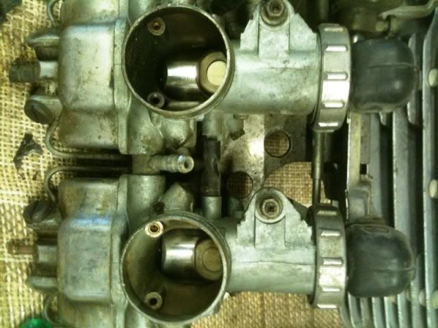

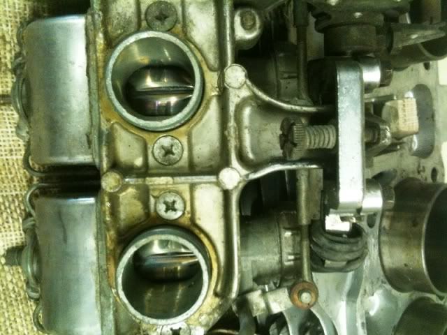

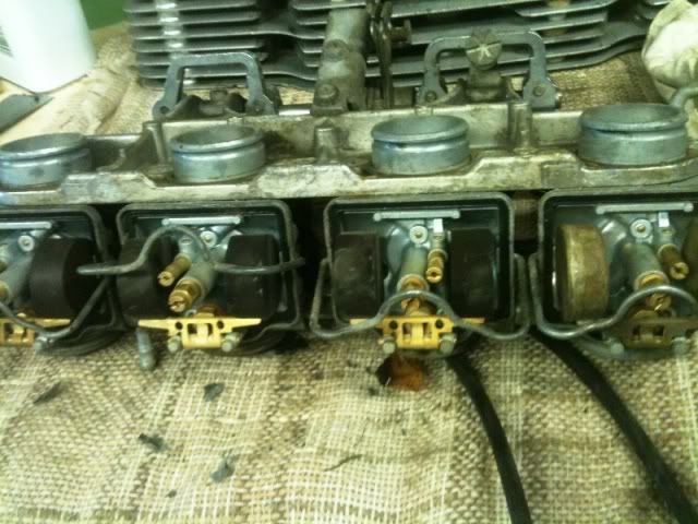

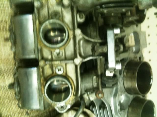

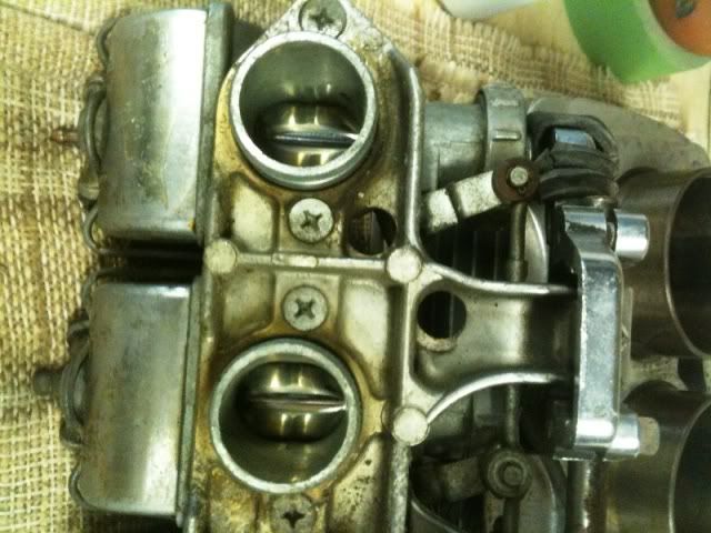

After I clean it , decide to check on carbs and how they look like after 40 years and mayself never so inside carbs except in photo.
Not bad ,what do you guys thinking ?!I seen here worst .
But somebody long time ago was working on this one.
On the top of the carbs there is a three  bolts 10 mm and one Philips instead.So I will change that one for sure.

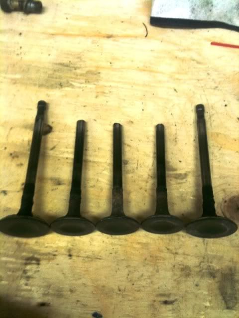

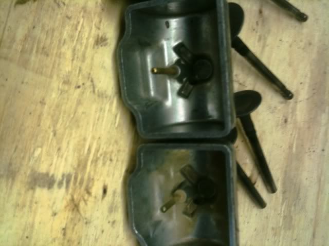

So then I decide to remove valves .Didn't have a spring tensioner ,didn't want to wait on my budy who is building old Harleys ,he went in New Hampshire for Nesscar race , coming back tomorrow .
So I said I am going to do with a big clamp .
And that is where we  pay for no expirience. Thats what scares me of !
So I put a clamp ,tightened from one side and took those two small triangle  things of no problem , spring to.
Keep on doing to the last one ,remove all 8 of them.
I was happy and then I look at it , three valves were bend  no to much but
you can see it easily !
So I f.....
Five of them get out no problem ,didn't now what to do with other three.
Try to straight them with wise grip ,no working.
I took Dremler and cut them and they come out after.
No bigie I was thinking to change valves anyway .Here is a photo three short ones ,others fine.

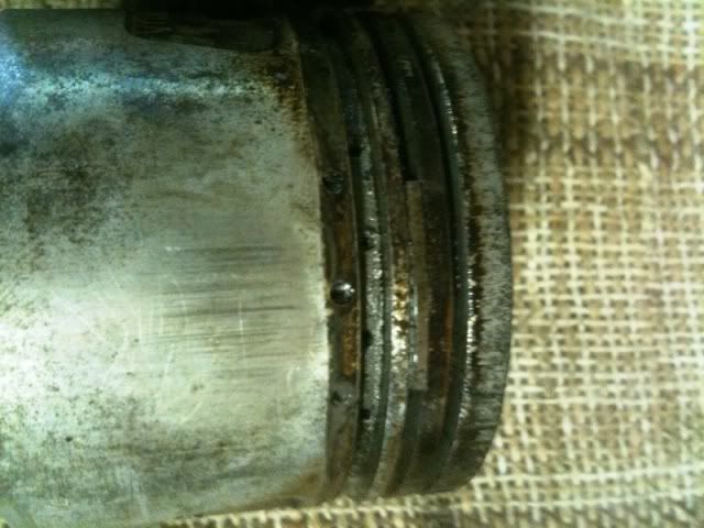

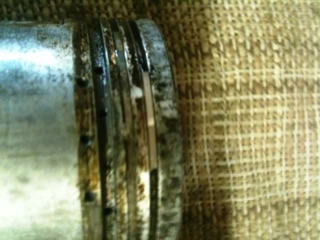

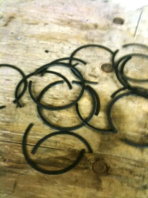

Next task to remove piston rings ,i was wondering pistons are o key.
Remove rings  clean little bit pistons and decide to replace them to .

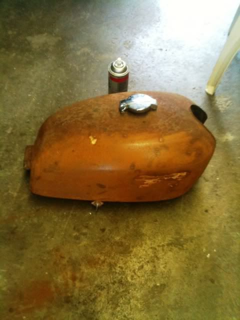

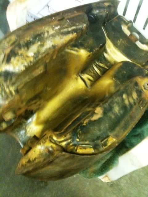

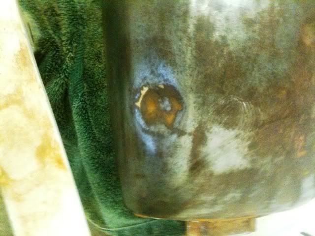

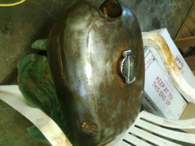

Want to call of the day but change my mind and strat to clean that rusty tank .Somebody didn't like that Honda sign on it and put a lots of bondo on it.
Before
And after 45min - one hour :Clean bondo but it's going to be more sending .
This is a big dent ???
Tank in original golden color undernet ,but I will change it to orange -red.
That's was all for this weekend,thank you  for reading and advising  me guys !

Yes , it will lift right out with the generator/flywheel still attached.
Thanks ,so after separate cases ,remove chain , just boom out ?
Z
Yup should just lift out
