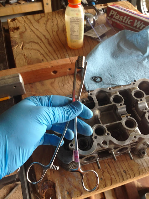

Next up, was yanking the old valve seals. Easier said than done, considering that they have a little washer in them, a clip holding them on, and you can't scratch the valve guides. But with some experimentation I figured out that I could snap my nice, big forceps onto them, brace the the whole thing against my thumb, and pop them off.
Just like this:
Gotcha you little bastard!
Next, we headed over to the drill press, jammed my custom plastic spring compressor tip back into the chuck, stacked up some wood as a nice little cradle, and with one person holding and the other operating the press, we got those damned little wedges jiggered back in. Some of the springs had high sides, so they didn't like to sit totally even and getting the wedges in took quite a bit of poking. Oh, and those forceps? Yeah, my neat little trick of sticking rare earth magnets on them to get those washers out completely magnetized them. I could get stuff in, but I couldn't let go. Serious pain in the butt. Luckily, my brother had a smaller pair that was NOT magnetized. Seriously don't know what I would have done without that kid.
Here it is, all build up.
