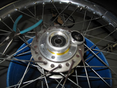

Here's a pic of mine once I had drilled it and taken out the retainer. Don't be too afraid to drill it out, I couldn't break it lose till I did. As you can see it's not super shallow...the threads that is. Good luck!
