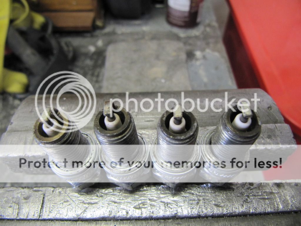

Are you sure you're running lean? Can you post a pic of the plugs?
It's hard to imagine a lean running bike not reving over 5k.
Tom
Offline mlake01
  • Posts: 5
Re: Introduction and CB350F lean issue
« Reply #10 on: August 27, 2012, 08:08:15 PM »
Tom
Yep, it's lean - like, super lean - choking it improves things.  Here are the plugs after a ~3 miles test run:
Following an earlier suggestion from this forum, I used a piece of aluminum sheet and some duct tape to seal up the top of my airbox (where the missing lid would have been).  This made the biggest difference to date - easily a 60% improvement!!

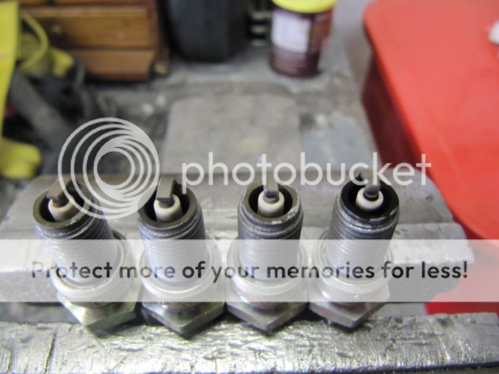

It will now rev right up to about 6,500 or 7,000 rpm in every gear before it levels off.  Adding about 1/3 choke brings it on up redline, whereas it used to need 3/4 choke.  Pretty impressive improvement for a simple airbox lid!  Kind of makes me wonder if a tank of real gas might help (we have 10% ethanol in The People's Republic of Oregon) too?
Here are the plugs after the airbox lid modification:
Better, but still a tad lean.  I think my next step is to give it the fuel it wants - raise the needles 2 notches and put in some #80 mains.  Too bad it's such a &#%$!@ chore to raise the needles...

Looks like your on the right track.   ;)
