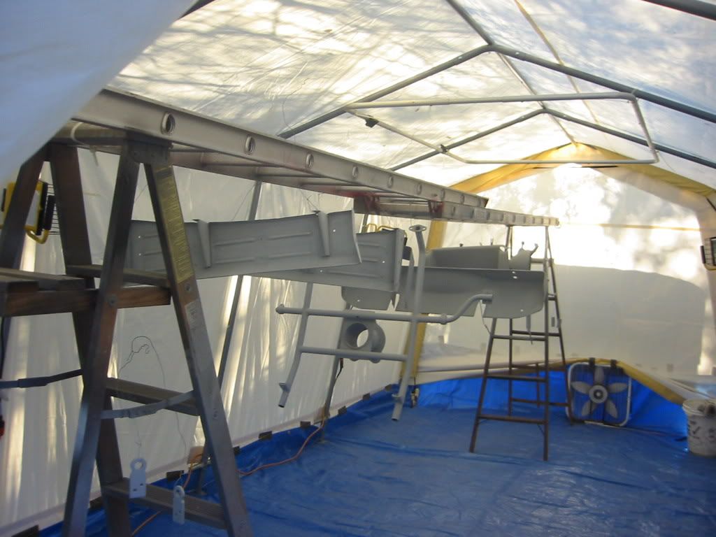

And....if you need a nice clean environment to paint, and plan on doing more painting, you can get a portable paint booth. When I painted my MG I bought one of those 12 x 22' fully enclosed portable garages from Northern Tool. It was like $279. Took a couple hours to put up. I used a large poly tarp for the flloor, hung some 500w halo lights on the side walls, ran my air line out there and located a regulator and water trap out there. Set this up next to my garage. The pipe structure provides a natural location for haning wires for suspending parts. The protection keeps bugs and dust off. I wet the floor prior to painting. I also put a box fan on one end to draw fresh air through, had a simple filter on the other end. Basically a fully enclosed paint room for $300. When I was done I took it all down in about an hour and boxed it up for the next paint project.
Best $300 I spent for painting. No worries about moving wet parts, crap getting on them, rain, direct sun, bugs, etc. etc.
Here is a pic of my setup.
Very nice. I love it.
