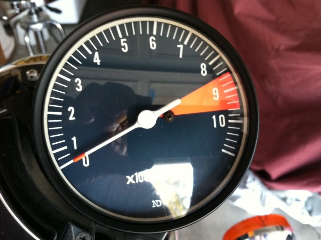

Offline Trevdawg
  • Posts: 120
I need all of your help on this!!
« Reply #12 on: September 29, 2012, 05:23:34 PM »
The front is good. You should see how the housing/ back of them are rusted.
Was green a common color on the gauges??
Offline LesterPiglet
  • Posts: 4,045
  • 1977 CB550F2
Re: I need all of your help on this!!
« Reply #13 on: September 29, 2012, 05:27:28 PM »
I may be wrong but I think only the 77 F's were blue. If you mean the chrome backs that doesn't matter, I have new ones.  :)
  • Posts: 35,228
« Reply #14 on: September 29, 2012, 05:27:36 PM »
'76 & 77[?]
Offline Trevdawg
  • Posts: 120
« Reply #15 on: September 29, 2012, 05:46:47 PM »
Well the 74 - 750 I had, had green gauges too. But then it had the green panels, tank also.

Offline toytuff
  • "watching the pinheads"
  • Posts: 4,349
« Reply #18 on: September 29, 2012, 06:00:20 PM »
Blue was used on the instruments in 1977 on both the K and F.
tt
