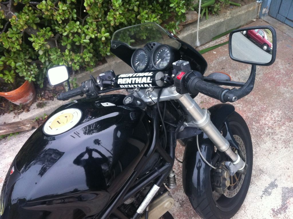

Well, I got 'em finally...and I learned a bunch. The main thing to take note of is that the inner diameter of the bars in smaller than regular steel bars
I have Road- UltraLows that will be going on my CB and I will nee to shave material off the triple trees as the clamp tightens all the way down and the bars still move slightly
I also learned that Renthal Grips are really short.  Not using them on the Ducati...maybe the Honda, will have to see
The bars are very nice and the finish seems to be bomb-proof. I had to mount and remount the bars on my Ducati to re-route the control cable multiple times and the black finish ddi not mark up at all...impressive

« Reply #17 on: November 15, 2012, 10:28:01 AM »
Yeah - I went with a steel powder coated bar with the identical bend for the 750 - I want to internally route the controls.  Still have my Renthal Ultra Low kicking around - I may use it on the F7.
Looks great there SKTP!
