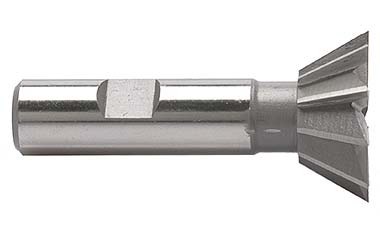

find a small diameter one of these with the proper angle and go for it?
