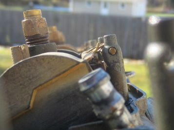

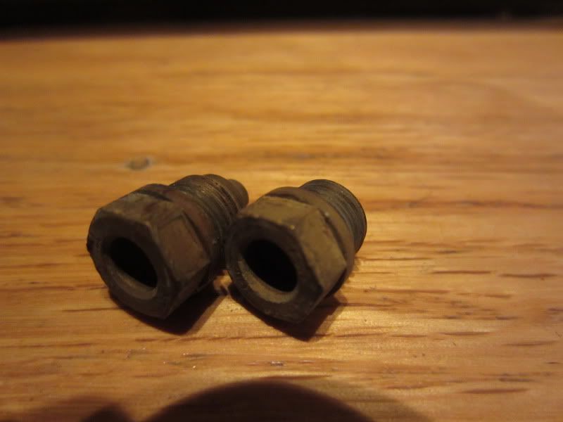

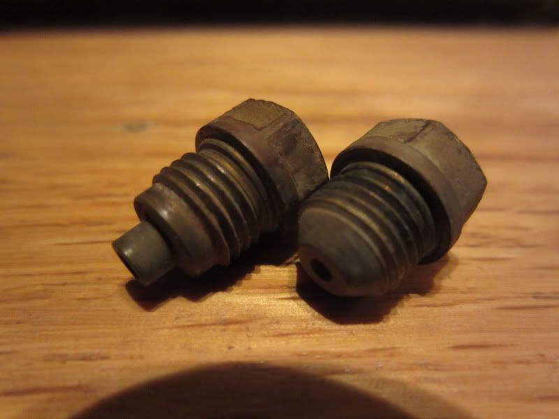

My '74 750 came with a gutted mac exhaust (completely open) and pod filters.  I want to go back to a stock airbox and have a superstrapp exhaust ready to mount in the spring.  I've got the carbs apart for cleaning and rejetting if necessary...  A few questions so far.  The #2 carb has a different float needle seat than the other 3, it has sort of a bumpout on the bottom (#2 is on the left in both photos below).  Would the other 3 be the stock parts?  The #2 is the only one with keihin markings.

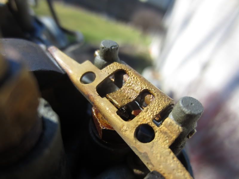

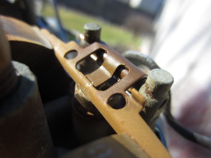

Next odd thing - the float in one of the bowls was corroded and the tab bent to a point where it did not even touch the needle when fully "floated" (tried to show this in the last pic).  Why wasn't that carb leaking all over the place?  Bike idled fine but otherwise ran like crap when I started it up this fall.  Its possible I did this taking the bowl off but I was careful (i thought) not to bump anything.  Last question - currently there are stock idle jets and 130 mains.  I am not sure what the mains were stock (shop manual says 120 but I wasn't sure of the years) - what would you recommend?  Never messed with this before but based on a formula I found somewhere on here I was thinking 125?

The stock main jet would have been around #110 or #105 on the 74. That 'bump out' needle seat looks like a later model that has a built in fuel filter on it.If it is they do pull out.

Some kind of stupid repair.
Just get 4 new float needles and seats!!
End of story. Those look old and beat up anyway.
And No ...you cannot polish them into being serviceable. Forget that.
