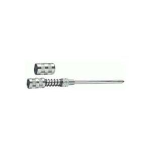

These zerks are used with a needle attached to your grease gun. Here's one at Amazon.com
http://www.amazon.com/Plews-05-025-Needle-Grease-Adapter/dp/B000CCIM1A/ref=cm_cr_pr_product_top
Stu
MCN DTF
Offline SohRon
  • Posts: 946
Re: Zerk replacement
« Reply #9 on: January 11, 2013, 12:00:01 PM »
Stu
If you're refering to the original Honda zerks then, no, this special adaptor is not needed; frankly, I'm not sure just how the above mentioned needle would work. Just a rigid pipe on a standard grease gun; in fact, most new grease guns come with a pipe and hose in the kit.

That NEEDLE fitting is for HIGH PRESSURE grease fittings , they look like the oil orifices in the head. The HP ftgs are mostly used in AIRCRAFT. Some of these HP ftgs use a special gun that sprays grease out the needle at 2500PSI when you pull the trigger!!
Worked AIRCRAFT for 45 years!! and have greased many airplanes..
