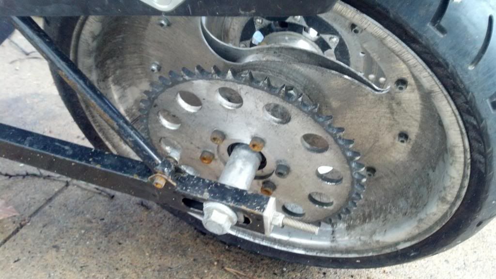

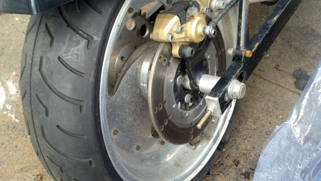

Yep...we ain't done yet, Bill, you's got to have a bigger rear wheel! Right, so Santa was late, but he brought me a one off 5.5 inch PM rear! ;D
Will this work? lol! ;) 8)
We are moving forward, all be it slow! ::) Bill     Thanks, you know who you are!!!!! 8) 8)

Nice toy rotor there Bill.   ::)
  • Posts: 15,017
Re: A Bike Is Born....750/1000cc
« Reply #186 on: January 12, 2014, 10:39:59 AM »
LMAO, here we go again....  ;)
Bill that tire is too rounded. But maybe it will hold better with that brake. Let some air out and get the rubber on the road.
Keep up the good work! You tinkering with all the bikes or is anything ready to go? What's the stable's update?
