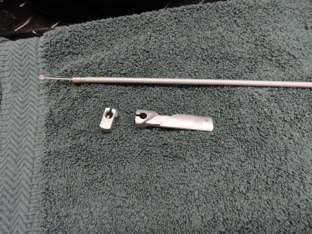

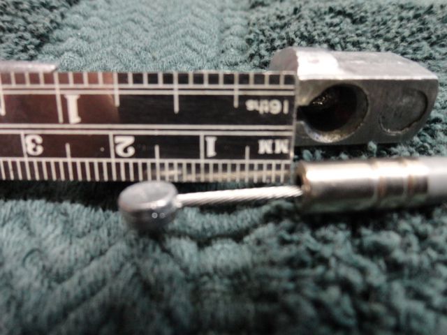

This didn't take long. Not long at all.
If you remember in an earlier post I said the cable was about 5 mm short. First cable was 37 3/8 inches. Second cable was 37 7/16 long. Neither fit.
I ordered another cable out of Canada from  siriusconincnosparts on flea bay. Even with shipping it was a few dollars cheaper than my East Coast supplier. Length was 37 1/2 inches.

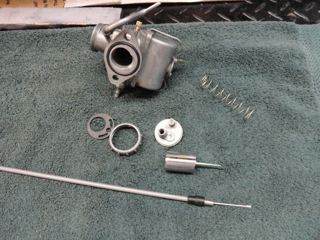

Lets begin. The assorted parts.
Throttle end.
Carburetor end.
Installed the cable into the carburetor and immediately looked at the throttle end.

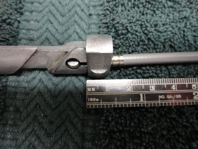

Well look at that. Around 5 mm where as the other two (2) cables were flush against the outher sheath.

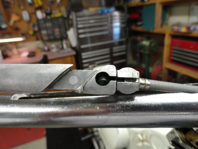

In this picture you can see where I slipped on the cable stop and the inner cable slide.
Still plenty of room huh? This was the issue.
In order to get these parts installed you had to pull the cable which then moved the slide at the carburetor.
This picture shows the cable adjuster turned to take out the slack.
I found some new OEM throttle end parts so I'll wait and replace them. I can install the carburetor and air cleaner tube in the meantime. After all, due to crap parts I'm getting good at this. Third time is a charm. Three (3) throttle cables later.  >:(
Still not happy about this. How many others are beating their heads against the wall? Crappy azz parts.
Still going to look for handle bars but the ones I have should work.
tt

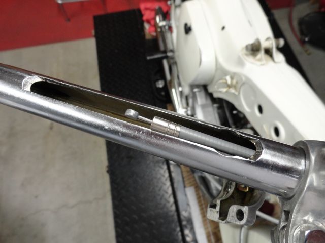

To continue..

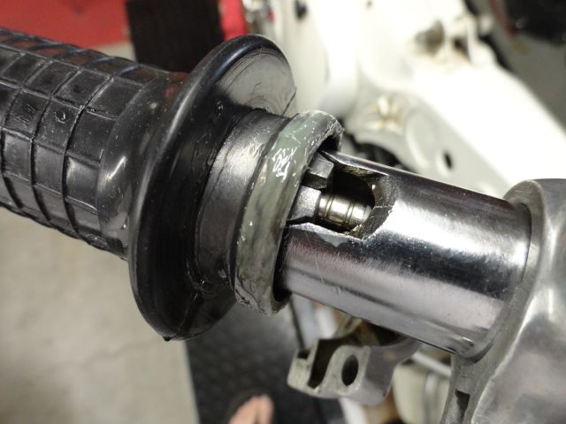

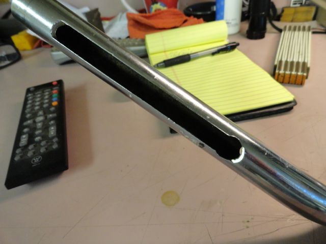

I ran the cable into the bars. As you can see the inner cable is showing. Last two (2) cables there was no inner cable showing.
We then installed the outer cable stop and the throttle slide. You can see a little slack.
Then..
And temporally installed. I'll wait for new parts to arrive and replace both the stop and slide. I still think this is the wrong outer cable stop. You can also see a burr on the slide.
When I twist the throttle I can now hear the carburetor slide hit the bottom. I could not before. There will be just a little more slack when I adjust the idle screw as it is turned all the way out.
Here is the deal. You buy parts to work. One should not have to reorder and screw around tearing apart your bike two and three times. Throttle cables on a Dream is not an easy project as you have to remove the battery, air cleaner, intake tube and carburetor.
I have the correct grips coming but will hold off until I find the correct handle bars.
Yeah, I'm done ranting and pretty much done with the supplier. More time wasted and more money in the build.
tt

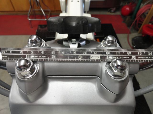

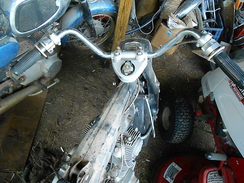

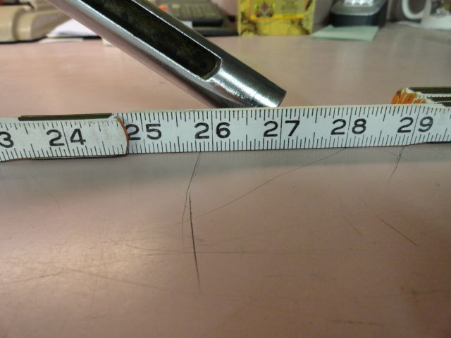

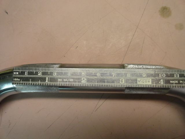

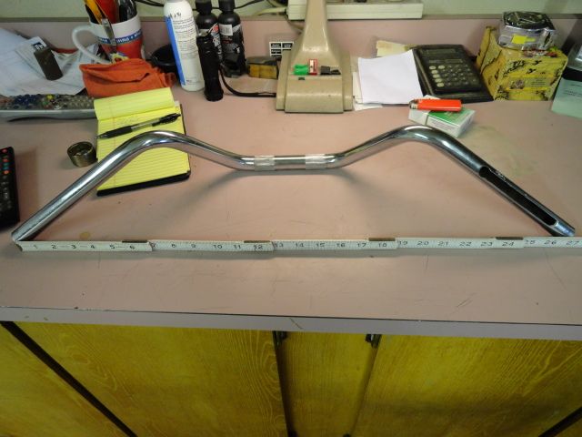

Handle bars.
I believe that Old Scrambler, Honda Nut and others are correct. These are not CA 77/78 handle bars but in fact CA 95 and possibly CA 72. I have looked at a lot of handle bars on a CA 72 and they appear to be the same.
Here is a set I bought of flea bay stating off a 305 Dream. Don't think so.
My top clamp width.
Width of bars in center.
They do not fit the top clamp width.
Ferrel to ferrel.
Throttle side. Notice hole location at very end.
My current bars. Notice hole location of outer cable stop.
More measurements of flea bay bars.
If anyone runs across Dream handle bars I'm pretty sure these are not the right ones. It takes this style. Notice the width at the top clamp.
tt

From the measurements shown on your pictures of that bar, it looks very much like it would be for the C95/CA95.  The clamp on my C95 would hold ferrels that are just over 4" apart at their ends.  The one I have had small ape hangers on it when I got it, so I used an old high-bar from a CB77 that I had around, and hand-machined a slot for the throttle slide.  It works, but it is just a bit off on size and shape.  A bit of the ferrels stick out from under the clamp, so it is a little too wide there.
Sending you a PM regarding yours. ;)
