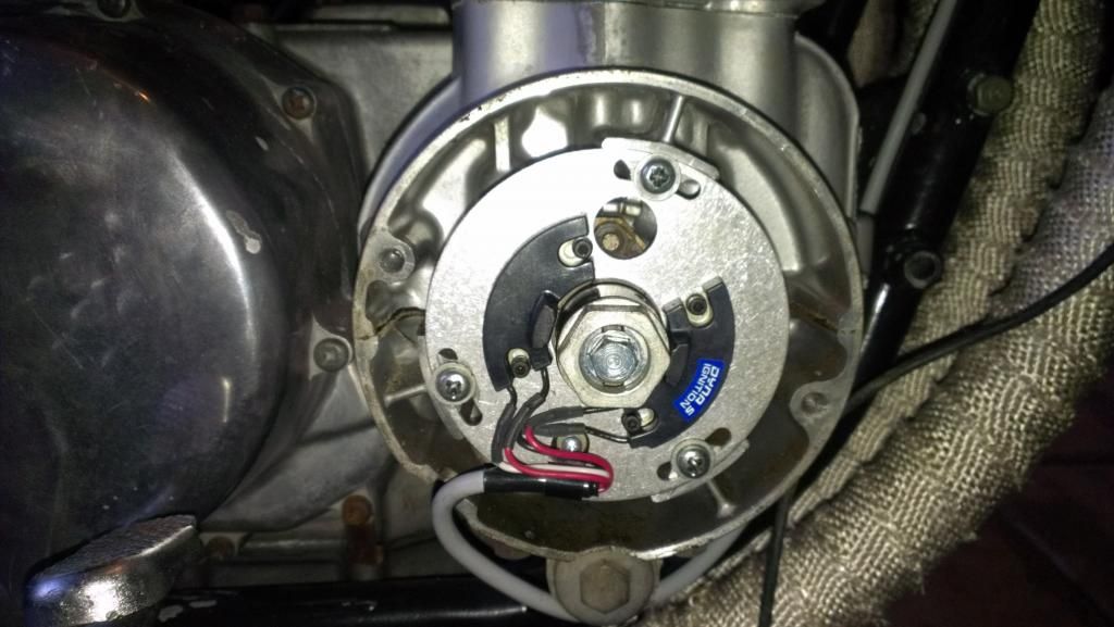

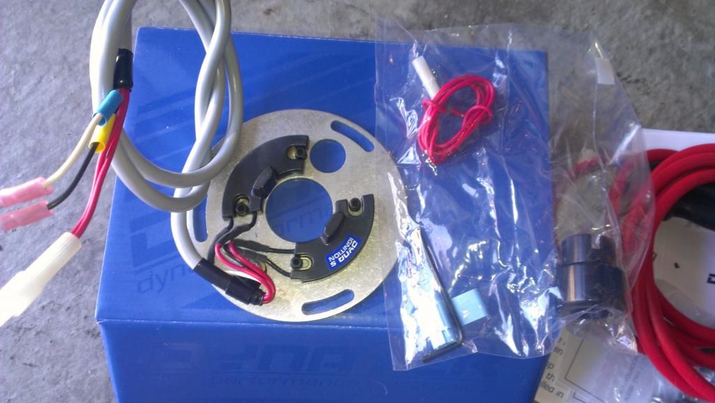

I bought it new from dynaman performance, it was a kit with the ignition, wires and black coils.
I'm not sure if it's a new design but here's a pic of it...
Coils have 2 poles, 1 pole on each coil was connected to the blue/yellow lead off the ignition and the other pole was connected to the red wires out of the ignition and to a switch 12 volt that only has power with the key on.
So I'm 99% sure I did that part right.
It doesn't matter how I connect the wires or off of what coil.  only spark to 1 & 3
I'm pretty sure it can't be a charging system issue either..   headlight isn't hooked up yet and turns are removed.  so it only had the tail light on.  After I tried for a bit it was hooked up to my charger with the same results.
On the timing light I'm sure the lead was hooked up in the right direction and I know it functions correctly because I checked it against my car to be sure.  I will go out in a few and try grounding each plug and also try to reverse polarity on the light.

Well...  I tried to adjust the pick ups on the ignition..  They're not really adjustable in and out, they really only move side to side (like to advance or retard them)  The front one is about .030 from the magnet and the rear one is about .048 from the shaft.  They look to be inline with each other across.
I tried to run a wire off the battery straight to the coils/ignition, it had 11.99 volts and I still had the same problems.  I tried to adjust the pick ups a little but nothing changed.
This has me perplexed.   I'm ready to just go back to points.

If he's getting a spark from his #1 and #3 plugs Bobby, that means that both Dyna pickups are working, but somehow he's only getting spark from one plug wire in each coil. That's possibly the weirdest thing I've ever heard, and it supports Mick's theory that most Dyna "problems" are a result of owner installation. I think he should take it to a shop and get someone who knows what he's doing to take a look. Cheers, Terry. ;D

« Reply #27 on: April 04, 2013, 04:19:47 PM »
I changed back to points and still had the same problem.
I swapped the plugs as was suggested and cylinders switched.  They didn't really look fouled to me but the 2 that had fire originally did look cleaner than the ones that didn't.
I took all 4 out and hit them really good with a wire brush and like magic I had fire on all 4.
I feel like a real moron over this.
It still won't start but I suspect it's from not running the carbs out of gas back in November when I put it away.
I'm going to reinstall the Dyna ignition, clean up my wiring mess, mount the tank again and then try to figure out the carb situation.
Thanks to everyone for helping me.
