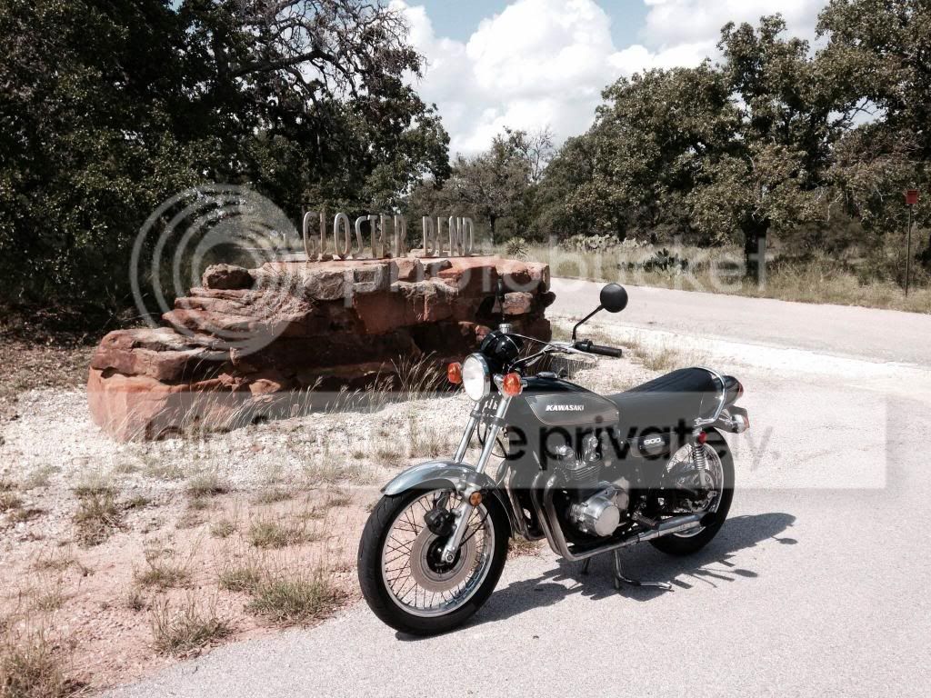

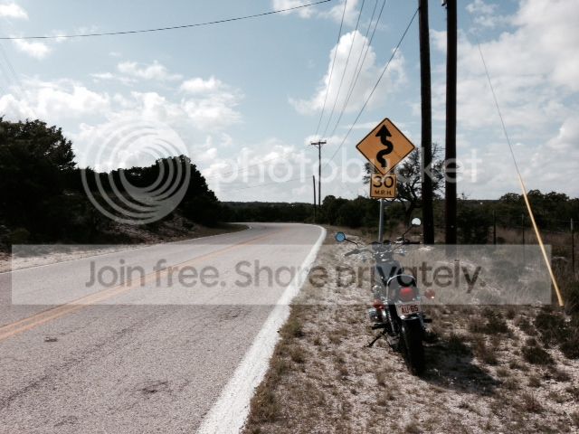

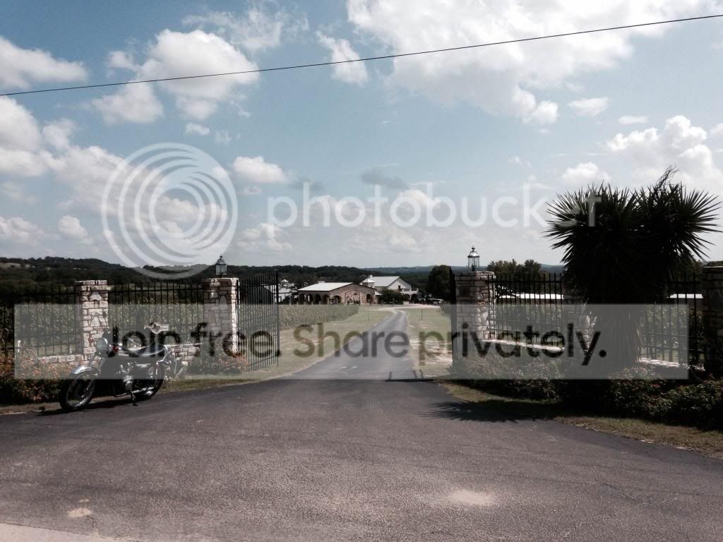

Took the Z out for a nice ride yesterday, now that I have two new tires and the proper 18" rear wheel, I felt more comfortable to push it a bit.
The motor runs strong, never missed a beat as a pushed it only to an indicated 95 a couple different times. The roads are very twisty around here so it's not like I have miles and miles of straights to do a high speed run.
Local county park...
Local winery... [a fav of the wife]
The motor does POP like hell on decel, obviously 'cause of the lack of a muffler with back pressure. I know the fix...
