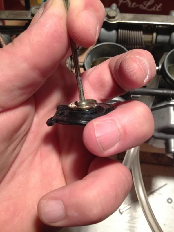

My accelerator pump was working great 2 weeks ago. I took off my bowls to put in new needles (I was having leaks) and noticed a couple of tiny bits of crap in the bottom of the bowl. Being anal I hit them with carb cleaner. While I was at it I decided to squirt the cleaner down the hole to the accelerator - just in case. I put it all back together and suddenly the accelerator pump stopped working.
Taking it apart I found that the diaphragm had two splits (see pics). I'm guessing that the carb cleaner sat in the pump reservoir and caused the diaphragm to weaken or become brittle.
Anyway I wont be allowing carb cleaner to contact the new diaphragm that I just ordered.
FYI - you should be able to check that the pump is working before putting the bowl on. Just put some liquid (other than carb cleaner) in the bowl and manually (gently) pump the diaphragm rod. If it is working you should see it squirt out the side hole at the top of the float bowl. Itll squirt out pretty hard - youll know if its working.
