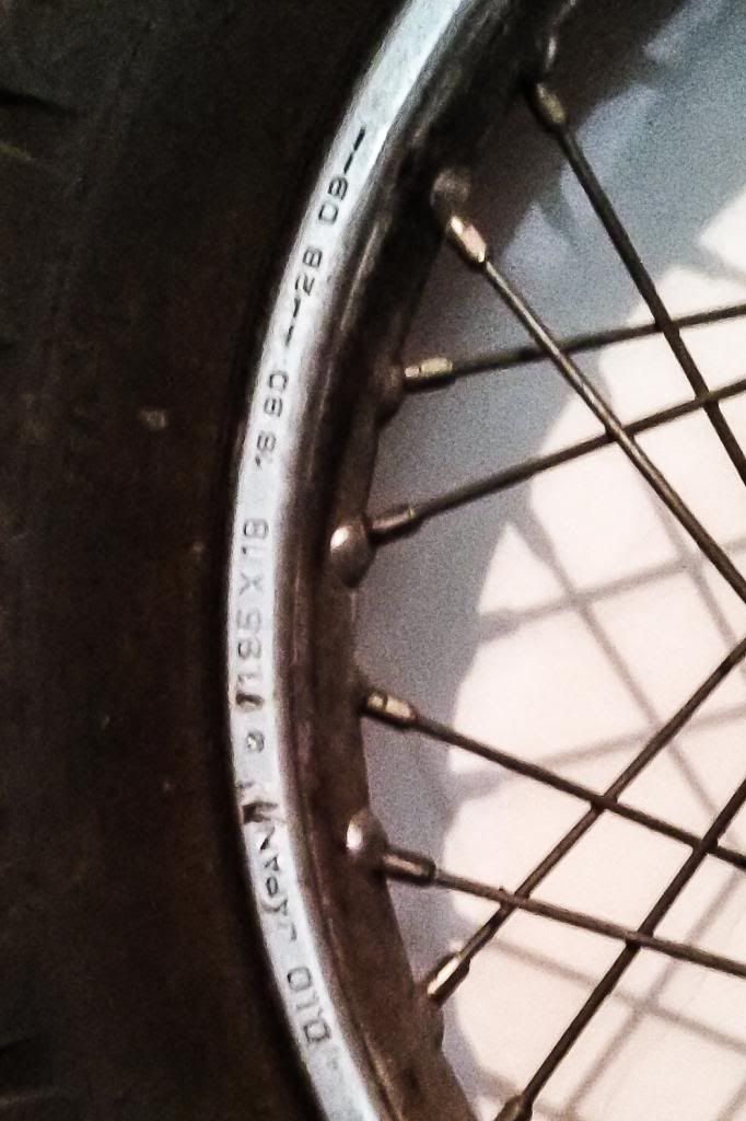

I thought 5.1 was a typo. Don't think I've seen one that wide on a stock rim.
Got a pic?

I just double checked and that's what it said.

Doesn't matter what size is on tyre, the rim is what you need to look at.
1.85x18 means you shouldn't fit anything wider than a 110 section and to be honest, even that is really too wide for rim
 I'm sure someone will post link to 'correct' tyre width chart, if not I'll find it later
Thank you for the info.

Here's link, grey blocks are  max/min size/rim width
http://www.mtsac.edu/~cliff/storage/gs/Motorcycle_Rim_Width_Tire_Size_Chart.pdf
