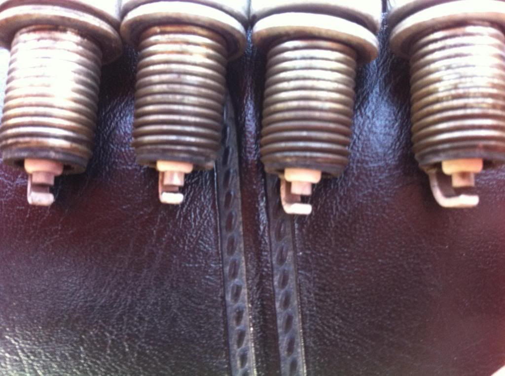

« Reply #12 on: July 10, 2013, 05:22:12 PM »
Not so white?

« Reply #13 on: July 10, 2013, 07:20:43 PM »
Looks like normal wear to me. I wouldn't worry.

« Reply #14 on: July 11, 2013, 07:43:48 AM »
+1 I don't see the white chalky looking buildup I saw when mine was lean. Those plugs look just right. ;D
