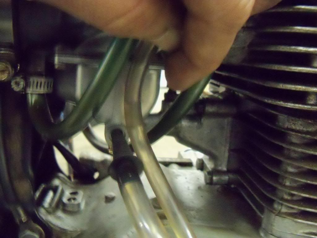

This is kind of hard to explain.  I think it might be covered in the clymer manual for cb750.  you need some clear tubing and some sort of fitting you can put in your float bowl drain screw hole.  First remove float bowl drain screw and drain float bowls.  Screw fitting into drain.  I use a tapered plastic vacuum nipple and just press in and twist to sort of let the drain's threads self tap the plastic.  Some have just heated the tubing and stuffed it into the drain.  It seals good enough.  Connect about a 6"-8" piece of clear tubing to the nipple and hold it up along side the float bowl.  Turn on the petcock.  Watch fuel level rise in the tube.  It will stop exactly where the fuel level is in the bowl.  Shoot for 3mm below the gasket and all 4 carbs at the same level.  All four carbs can be checked on the bike in this manner.  Just hold the tube for the inside carbs against the bowl of the outside carbs and as long as the bike is level side to side, the reading will be the same.
above pics are from a cb350k3 but the idea is the same...top pic is a decent level, bottom pic is bad and that cylinder would not even run.  Both pics the float height had been measured and set the same.

alright, tried the clear tube method and it worked wonders for showing me my fuel level......unfortunately (or fortunately) my fuel levels are all the same, about 1/4 inch from the gasket area. carbs are still coming off.
sidebar. my oil smells like gas. fairly strong. enough to remind me of my dads KX250, a 2 stroke motocross bike. also my exhaust smells a decent amount of gas. is it possible I am getting sufficient fuel through the carbs, but there is constant blowby of fuel past the pistons getting into the oil and exhaust...causing the lean condition all the time? I think this makes sense in theory. seems like an engine teardown and rebuild, something I am not ready for right now. if this engine has to come apart it I am just going to rebuild a donor motor, granted that I find one. sigh. carbs still coming off, checking everything, orienting boots properly, etc.
if my theory is correct then can I raise the needle jet one notch and prolong my engines inevitable doom so I can ride the damn thing until I can get another motor etc?
I should add I do not get smoke from the pipes of any kind, and no bluing of the pipes....so it LOOKS like things are fine from the outside. it also SOUNDS like things are fine. i have no other motorcycle let alone another cb750 to judge on smell, but it smells like 2 stroke gas/oil.
1/4 inch is on the lean side of fuel level. Make sure you shut off the petcock when the bike isn't running, as float needles can weep fuel when sitting and foul the oil, but not show up if the demand for fuel exceeds the weep.
