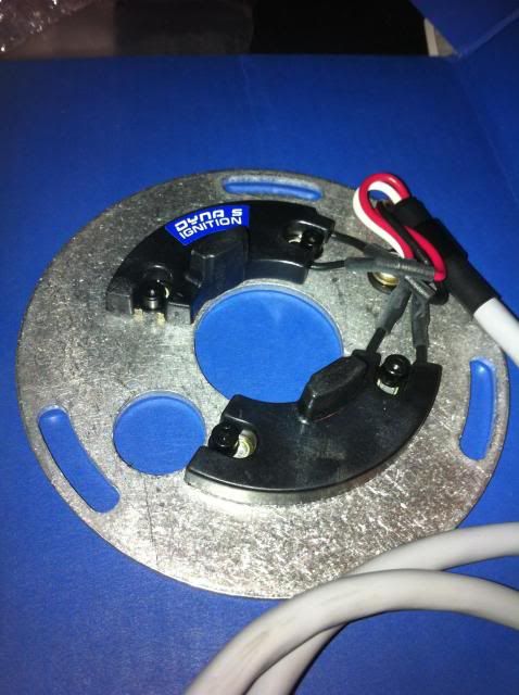

When I started this build I just assumed that going with a more modern electronic ignition would be the way to go over the antiquated points system. I have since seen some builders that have had issues with this unit. Did I waste $140 that could have been utilized elsewhere?

Is there a date code on the units. Since mine is new and still in the box I assume it is the latest version

I don't know so much about a MFG code, but the problem ones had larger pickup modules that were larger like  this example!
http://www.dynaonline.com/skins/products/sportbikes/dyna_s/
The new modules look more like the following; much smaller!
/sportbikes/dyna_2000_crank_trigger/

Mine has the smaller pick ups and came with a note saying the later CB400's came with a larger shaft on the advancer and the unit came with the smaller rotor that will have to be sent to them for replacement with the larger one.
