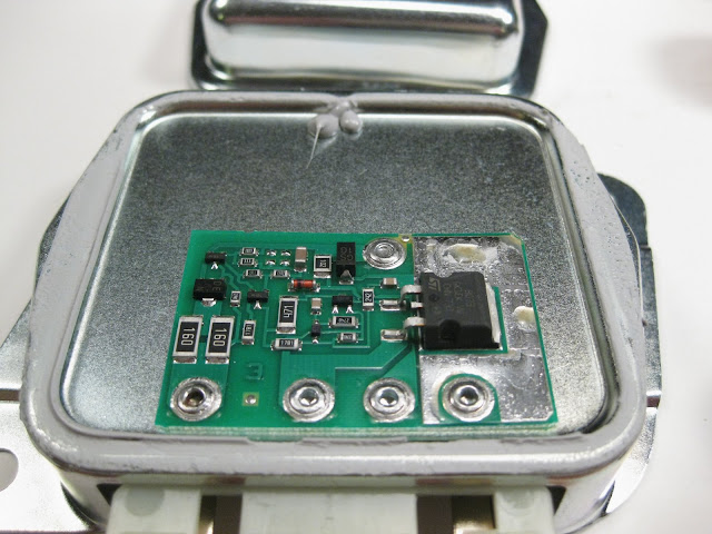

What a great thread.  I bought the VR730 Ford voltage regulator and I haven't changed much since I was a little kid.... I just have to take things apart (see pics below).  I'm trying to arrange my electrical "panel" and the casing on the VR seems a little bulky.

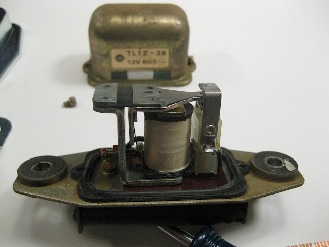

Here's the Ford regulator next to the Honda:
The form factor of the Ford is from the "olden days" when it was mechanical.  I'd like to chop down the enclosure some and I'm wondering how much heat I could expect from it.  In other words, is the case being used as a heat sink and how much of it (if any) is required?
Any thoughts folks?
I have a couple other parts either on the way or "in house" for my rebuild of the electrical panel.  More on that later... (blade fuse box, www.vintageconnections.com connectors, rectifers, heat sink, etc.).  This thread really catapulted me into attacking my electrical system and I'm glad I did - I'll document and report results - thanks!

Very interesting. I don't know how much of a heat sink the casing is, but I know it pretty well never gets even warm to the touch. I'm interested to see what you come up with!

Yeah, I don't think the case is much of a heat sink, you could definitely reduce the size of the casing and probably not heat up much.

ummmmm. I got crazy last night with the tin snips:
Thanks for your reply though.  I think you're right.  The more I looked at it, the more I thought it couldn't be making much heat.

I had a similar thought.  When you look at how much surface area there is in a Honda rectifier compared to the cover of the voltage regulator....  it looks like the VR730 would "serve the purpose".  My notion was to put the rectifiers inside and cut openings in the sides of the cover.
It's a good thing the VR730's are only $13.
