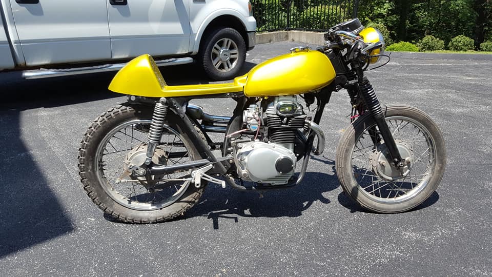

Got some time in on the 350 with the long weekend. The cam chain problems were in the tensioner. I had to grind out a fair bit of casting to allow for free motion of the KA. Once I did that things went together much easier. Also managed to get the engine in the bike with minimal scarring. Painted up the peg brackets and bar clamps. I also polished up the pipes some but there are a couple rust spots that need some sanding.
Next up I'm going to get back to working on those stupid gators and get them situated. Get the exhaust mounted. Maybe get some clubmans bought and fiberglass up the rear cowl. Probably sprinkle some wiring in there as well which might take me awhile...i suck at wiring.

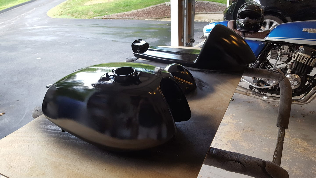

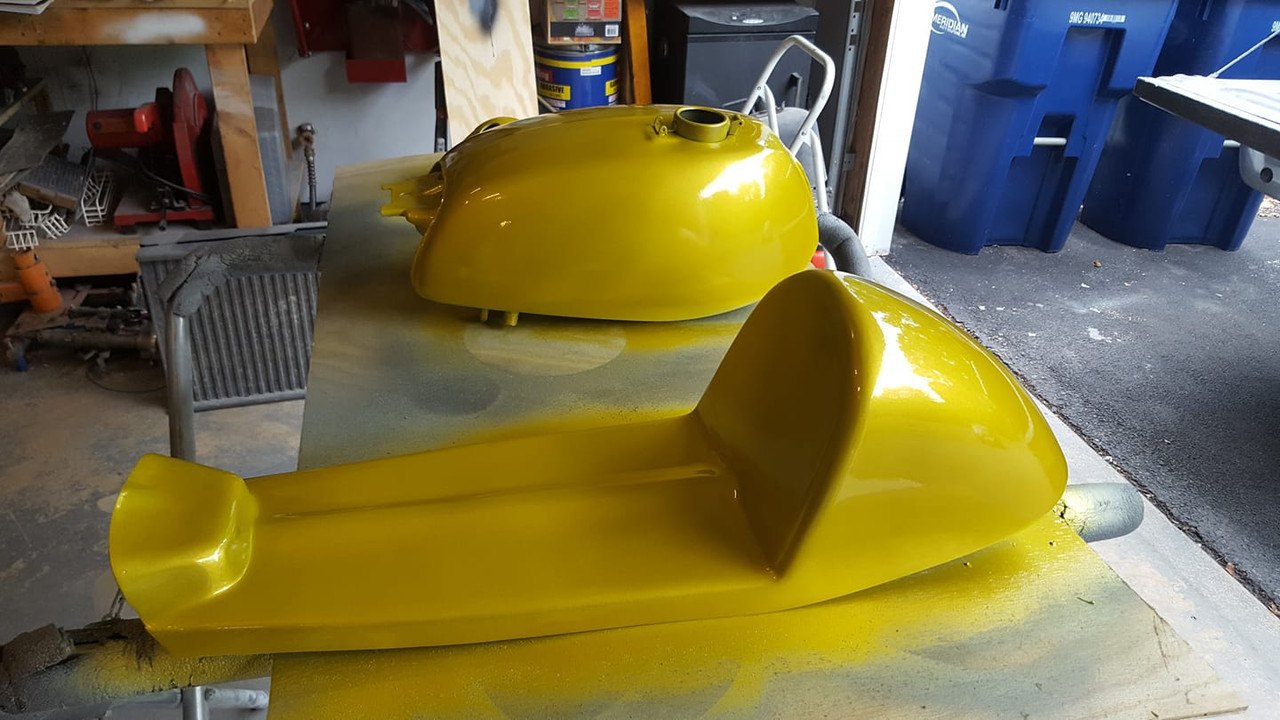

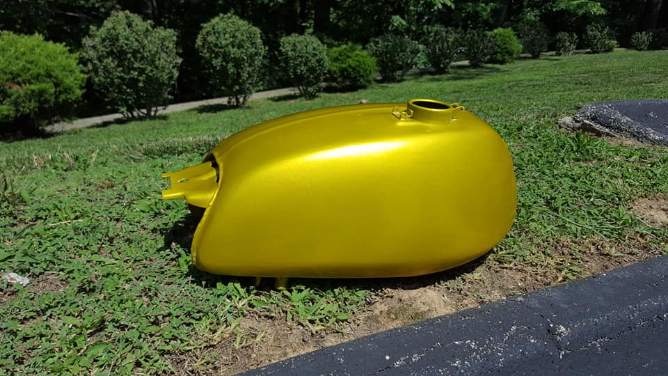

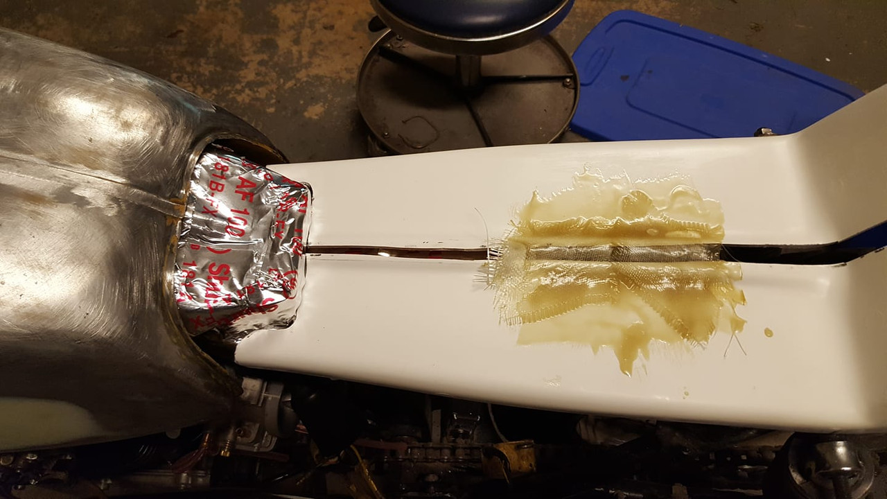

A few years ago i got a tail section for the bike but it was too narrow and didnt really fit snugged up the way i wanted. I ended up cutting it down the middle and widening it so that it fit the frame better. I also made it blend over the tail of the tank to better jive with the lines of the bike. I wasnt and am still not overly crazy of the hump size but figured it was a bit out of my abilities to try and lower it so I left it. It doesnt look really bad but I would have liked it to have been more the hump style of my 750. You win some, lose some.
I sanded the tank down to bare metal and worked out a couple dings. I gave the few low spots a really light skim with putty to make sure they were glass smooth. This turned out really nice.

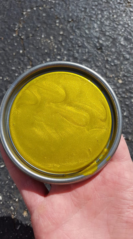

I then gave both pieces a couple sprays of gray epoxy primer followed by black epoxy primer. I use the opposing colors to tell when everything is smoothed out since it allows you to see the highs and lows while you're going through your sanding process. I ended up spraying another coat of the gray epoxy as a final prep coat. Then sanded with some guide coat this time just as a last check to make sure the thing was smooth. In choosing the color, i figured the bike was already gold...i just figured i'd make it a brighter gold. This was a really forgiving color to spray. There are a few imperfections in it but it was my first time doing an actual spray job so overall, i'm really happy with it. The next ones will be better as i learned a lot about my guns and spray patterns. This was a base / clear spray and not single stage. And at that point, i let everything sit for awhile to both let the paint cure and to have a child...

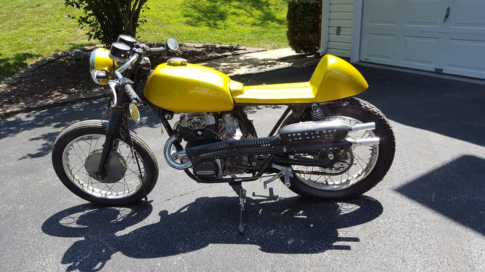

Time for the fun part...i started getting ballsy so I added a little gas to the tank, flipped the key, and two kicks later she roared to life!! I finished getting the clutch adjusted, exhaust proper installed, wiring tucked into the tray that I made under the seat and more or less getting it ready to go.
That cable solved a lot of problems. I had a weak starter which now spins over pretty easily even though, right now, I dont intend to install the solenoid. The headlight and turn signals all work now too.
I'm not really crazy so I dont want to take it for a run until i have new tires and tubes. Those will be here this week so fingers crossed i take it on the maiden voyage this weekend. I'm also getting air filters, a few more lighting items, and a couple more odds and ends to essentially wrap it up and then i can start tuning.

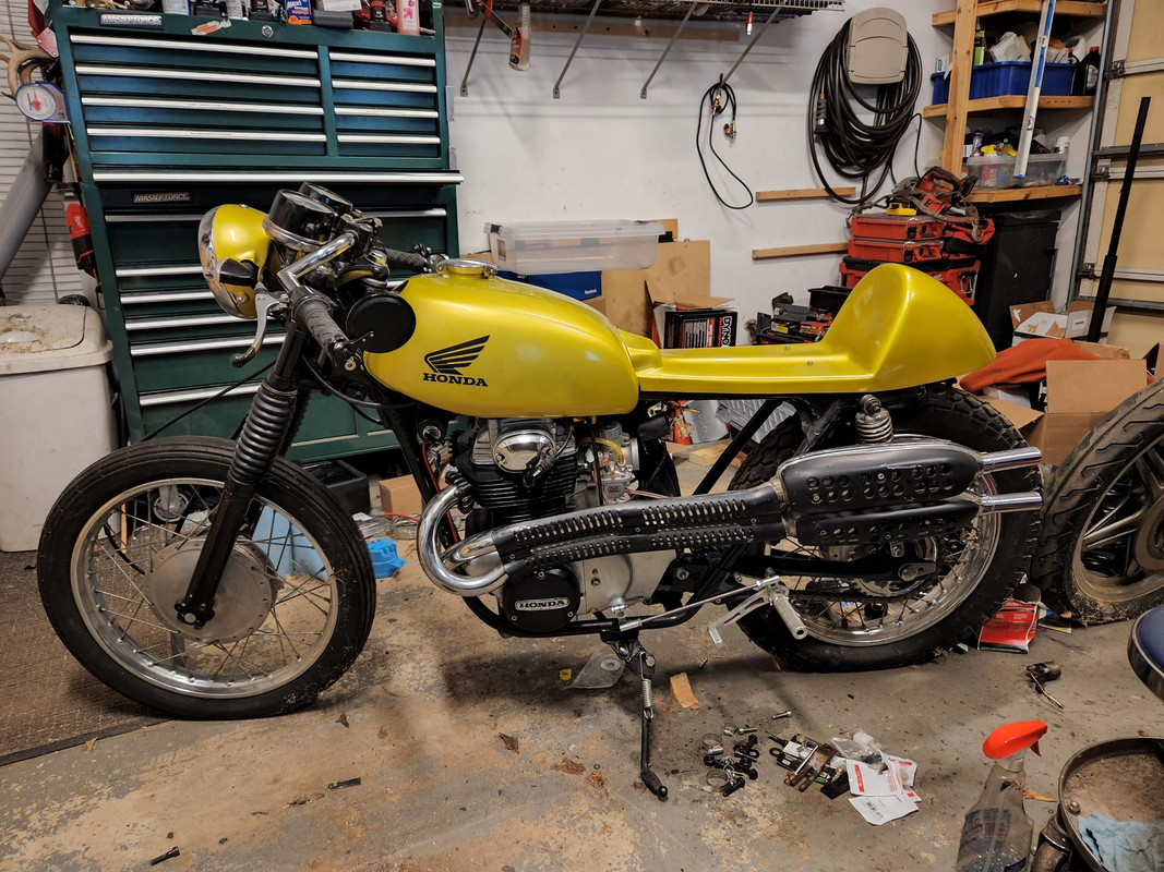

Worked on getting the tires and tubes changed today and realized why i typically pay to have that done. The front tire came off okay however i managed to pinch the tube (i think...its not holding air) when i installed it. I have another one coming tomorrow. I'm going to take it out later tonight and see what happened.
The rear tire had been off bead so long it was stiff and i swear it shrunk. I ended up cutting it off since i was buggering the rim trying to get it to slide over. The new tire and tube went in without a hitch and is back on the bike.
Fingers crossed i can get the front tire sorted out and then its road testing time!! Who's excited? This guy
