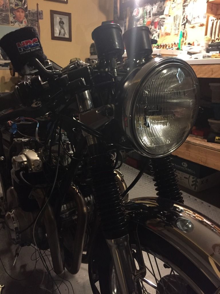

More wire and sleeving showed up tonight so I got a little bit more done. I got the front turn led's installed, headlight back on and sleeving installed for all three. I was hoping to run them all in one loom but they wouldn't fit in in the sleeve so I ran them all separately. Then I drilled the frame on both sides just above the mounts for the tank so I could install a P clamp on each side and keep the looms tight up against the frame. I'm finally ready to carefully end the sleeve on each of these looms (just downstream from the first P clamps) and deal with all the grounds and then run new sleeve back to the M Unit.
I also got new tabs made for the rear turn signals. They look that exact same as the last ones but 6mm longer.

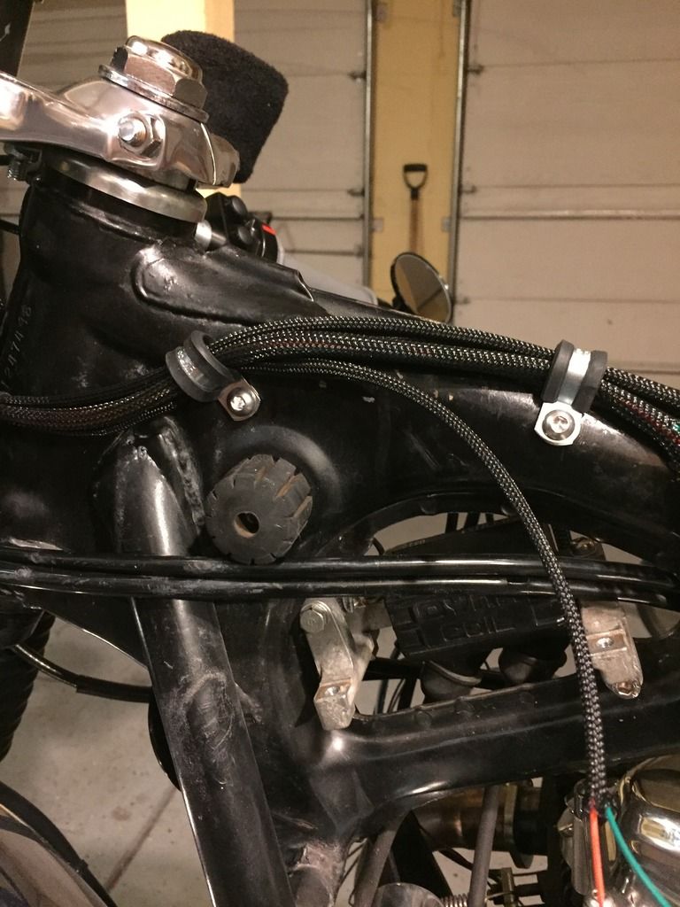

I know the lighting sucks but I love the way these Blaze turn signals look. And I love that there's only the wires for the turns and headlight in the headlight bucket.

Hey Riverman....have you tried to fit the fuel tank lately? That p-clamp looks a little high

Yes sir. I've had the tank on/off before installing them all. Fits fine.

The blaze turns are really really difficult to see.
Do you have enough clearance between the tank and your P clamp on the backbone?

You guys are making me panic. I had to put my martini down and go quadruple check the fit of the tank. The clamps up front aren't even close and the ones I know you're talking about, while a tad higher than what I wanted, have a whisker of room before they hit the top of the tunnel when I press down on the top of the tank real hard. The pic is deceptive.

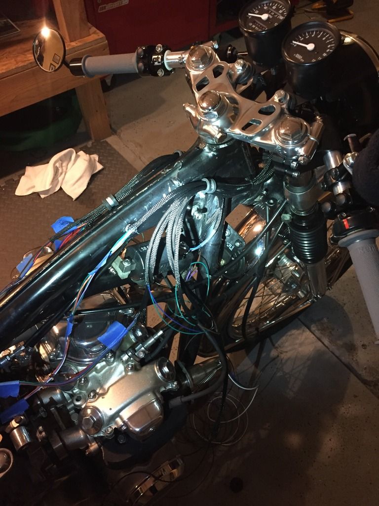

I was able to get some work done this weekend. I ended all the looms, dealt with the grounds, and then made new looms for the rest of the backbone.
Here's both sides all done.
Here's a better shot of the Blaze turn pins. I should have grabbed a picture of the headlight bucket. There's 7 wires inside. Three for the headlight and four 26awg wires for the turns. That's it.
And finally, I thought it would be a good idea to hook things up to the M Unit and power it up and see if everything worked. Horn, headlight (hi/lo), start, and both front turns worked fine. This was very exciting. The only issue was that the M Lock wouldn't work. There's only three wires for that and the other grounds grouped with its ground were fine (switches worked) so I didn't think that was the issue. Brown was straight to the M Unit and red went to battery POS. So I took apart two looms so I could see all three wires and the soldered joints. I removed the heat shrink from each wire and, while there was a little crispy spot on the brown (which could have happened while heating the shrink) they seemed fine. I cut each wire so everything was clean, used jumper wires and ran red to battery POS, green to battery NEG, and brown back to the M Unit LOCK. Nothing. This is strange because Cal walked me through how to power the M Unit and M Lock on the bench not long after getting them and we programmed the fob and they both worked perfectly. Not sure what the issue is now.

Chris,
Where did you get the little rubber loops that you screwed to the frame to hold the wires?  I like the look of those; it makes things look really tidy.
Oh...and I'm sure cal will aid in sorting your wiring but if it's only 3 wires, I would "test" the M-Unit again by just running 3 separate temporary wires.  I'm sure one has to come from the battery so replace your current wire with a new temp one directly coming from the battery.  One of them is almost certainly a ground so run a new ground wire to somewhere you know will ground it.  And then run a temp wire for whatever that 3rd wire is (maybe a wire from the ignition switch to provide switched power?  If so, you could just run a 2nd wire from the battery to it so that line is getting power as well).
If that fires up the M-Unit then the issue is on one of the 3 wires.  And I'd put my money on the ground most of the time.
Those are Adel clamps, available at Lowes, Home Depot, etc. they're about $2 each at Lowes, for the smaller sizes.
We use them on aircraft at work, and have them from 1/8" to 4" opening.

This is precisely what I did last night. I cut all three wires for the M Lock to remove the soldered joints from the equation and used jumper wires. Red went straight to battery POS. Black/green went straight to the ground at the coils and brown went straight to the LOCK port on M Unit input side. Neither fob did anything. I'm concerned because when I first got all of this stuff, Cal walked me through things and we wired it up on the bench and programmed the user fob and everything worked great. Since then, it's been sitting in a box on my bench until I got the mount polished recently and installed it and ran the wiring.  >:(
