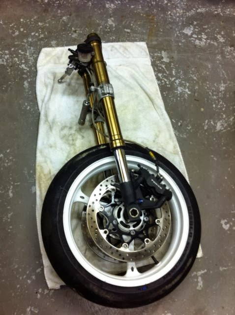

some progress today bought a GSXR front end complete from the bay
looking to to buy this spoke hub conversion in the morning
will start the strip down at the weekend cheers Andy

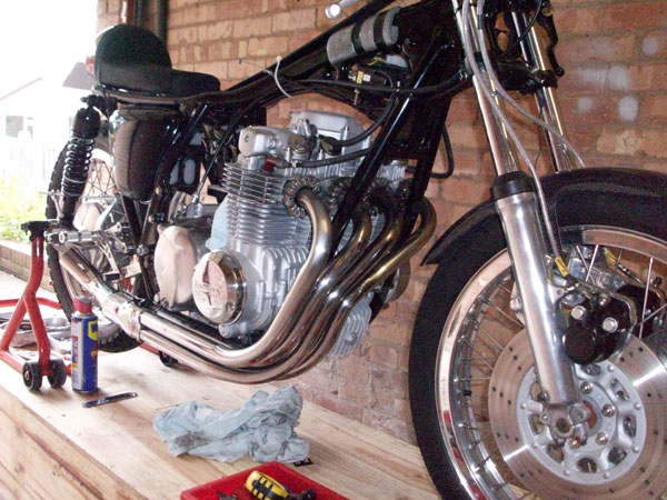

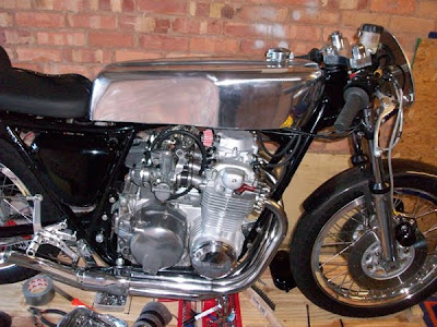

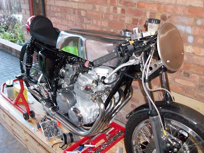

here are a few pics from my previous build
looking for a finish as good or better on next one

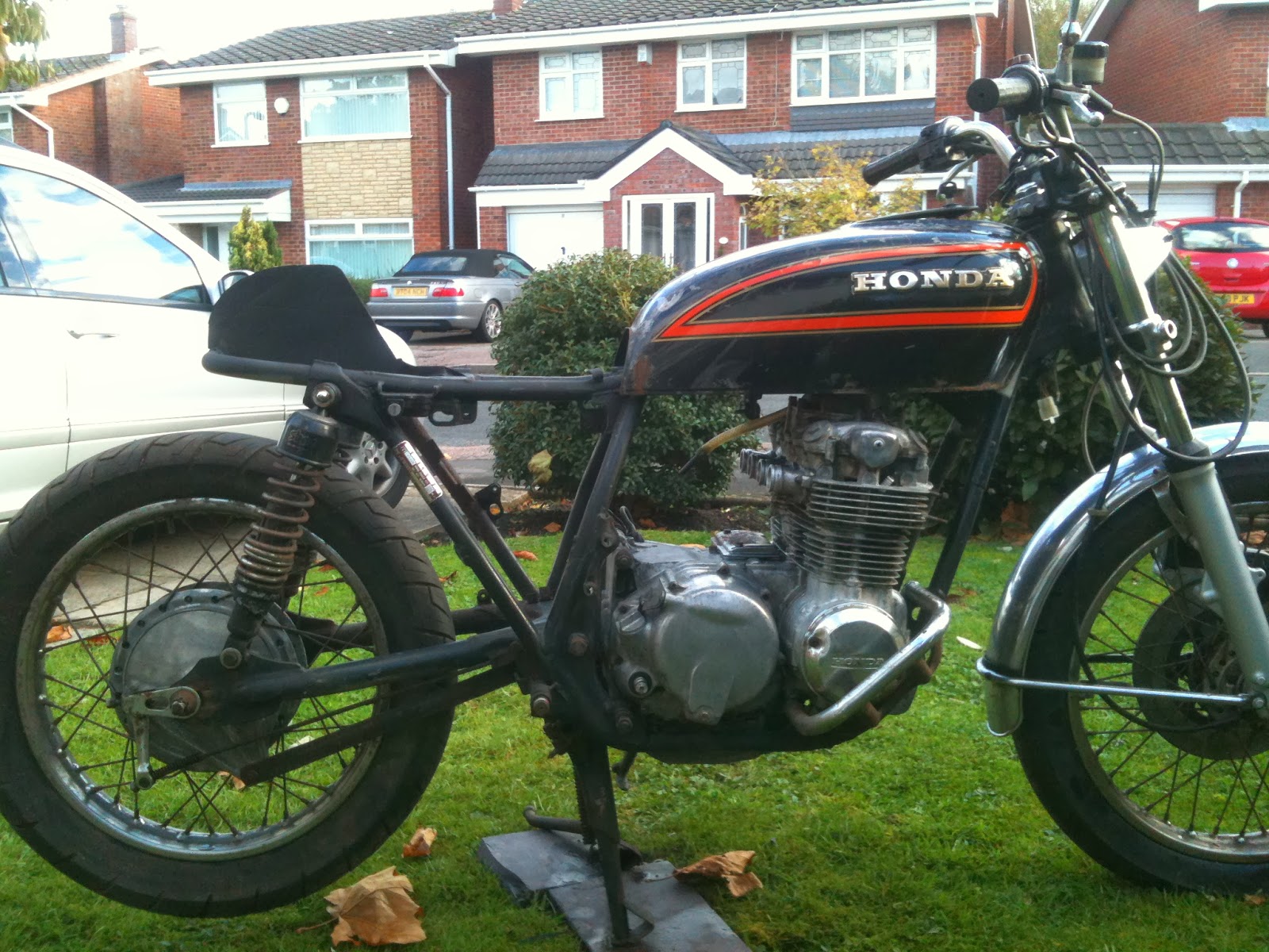

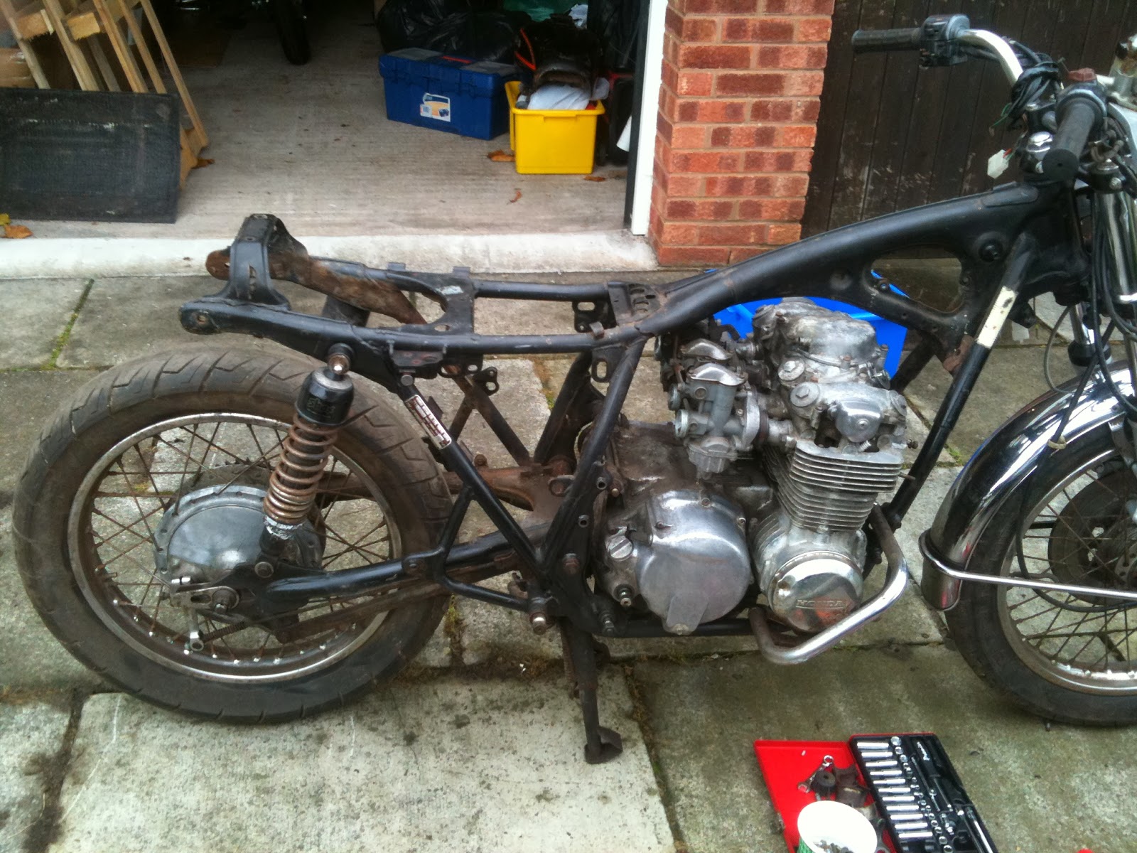

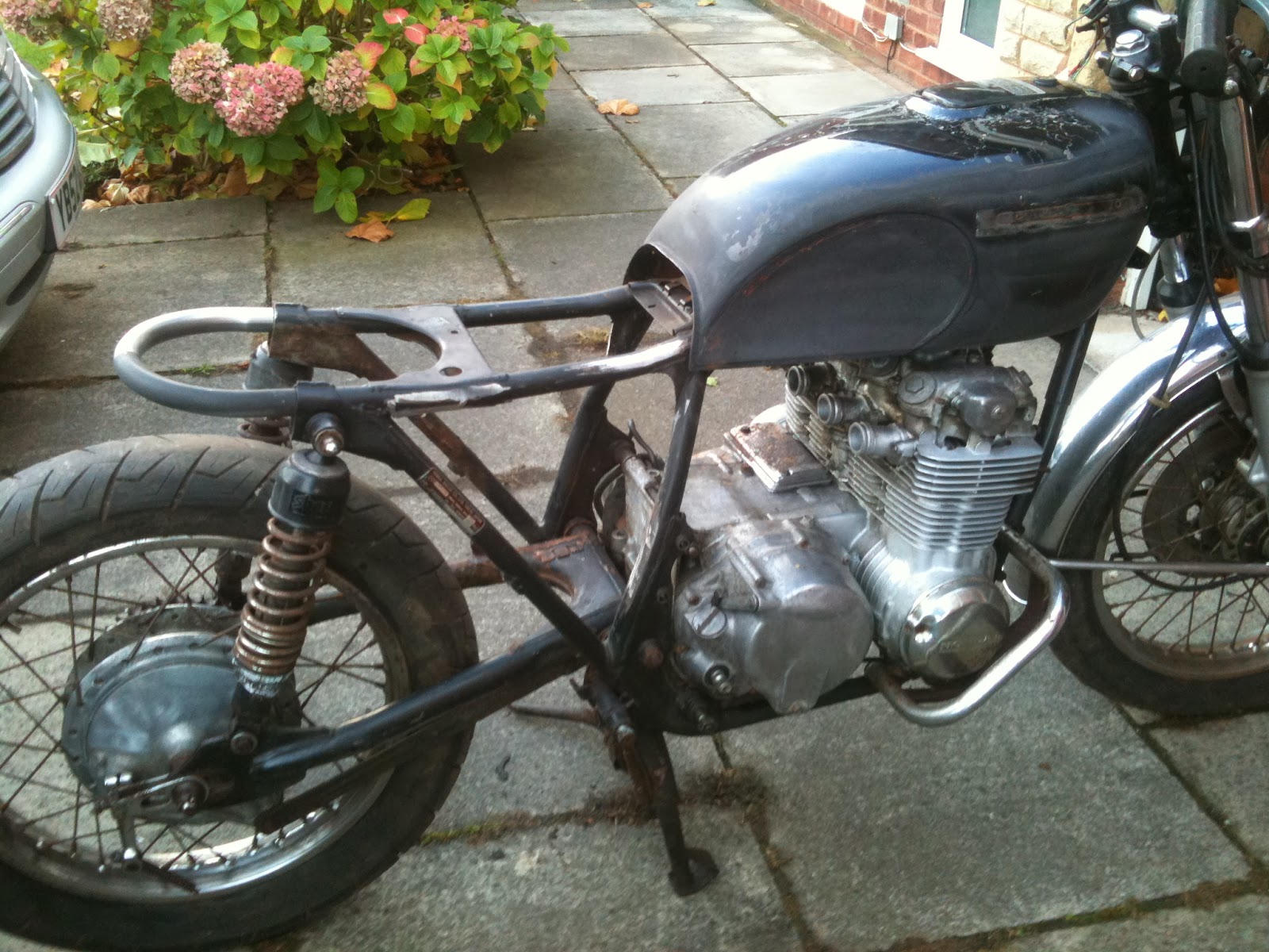

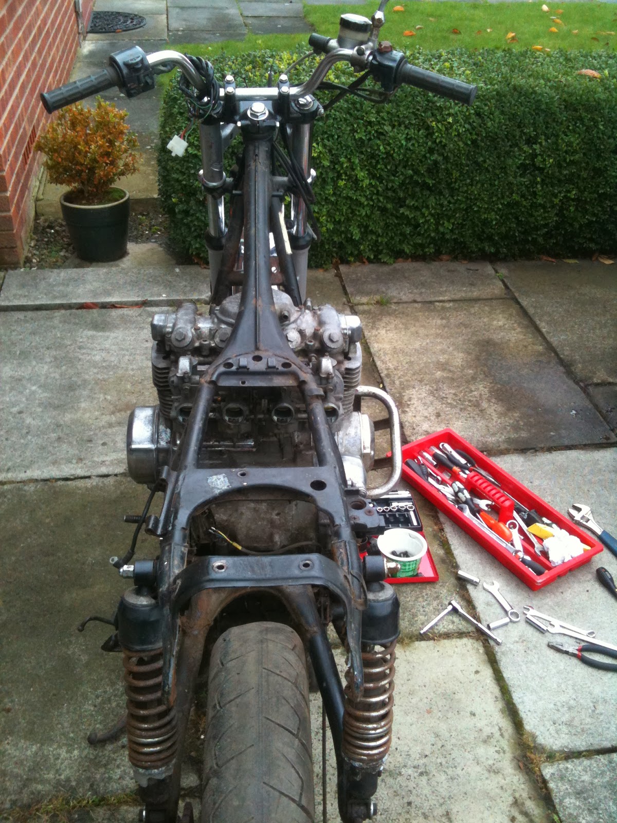

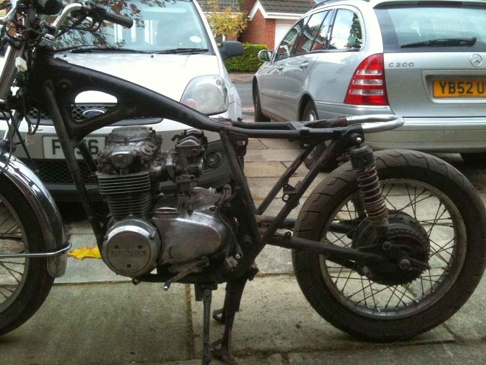

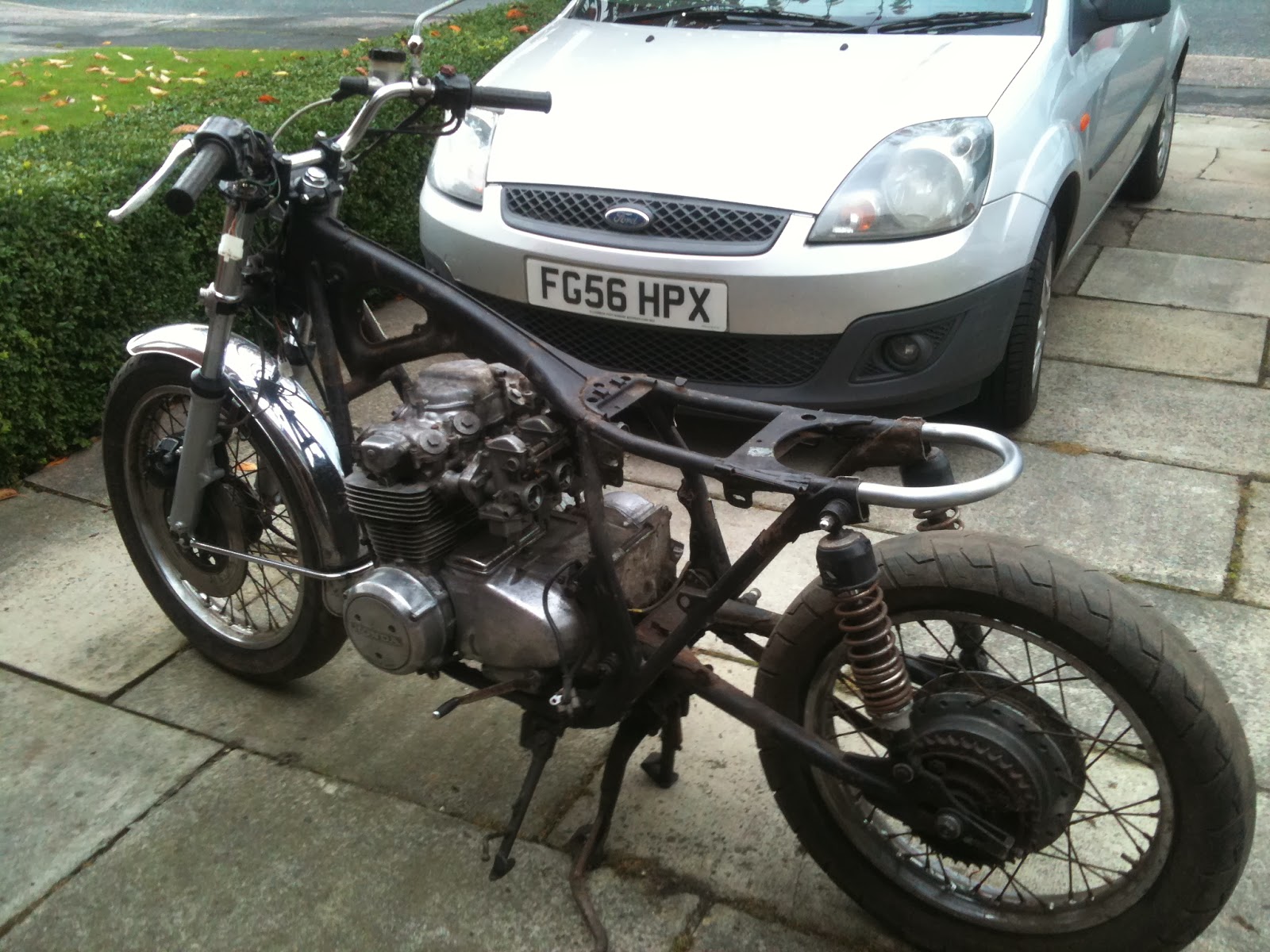

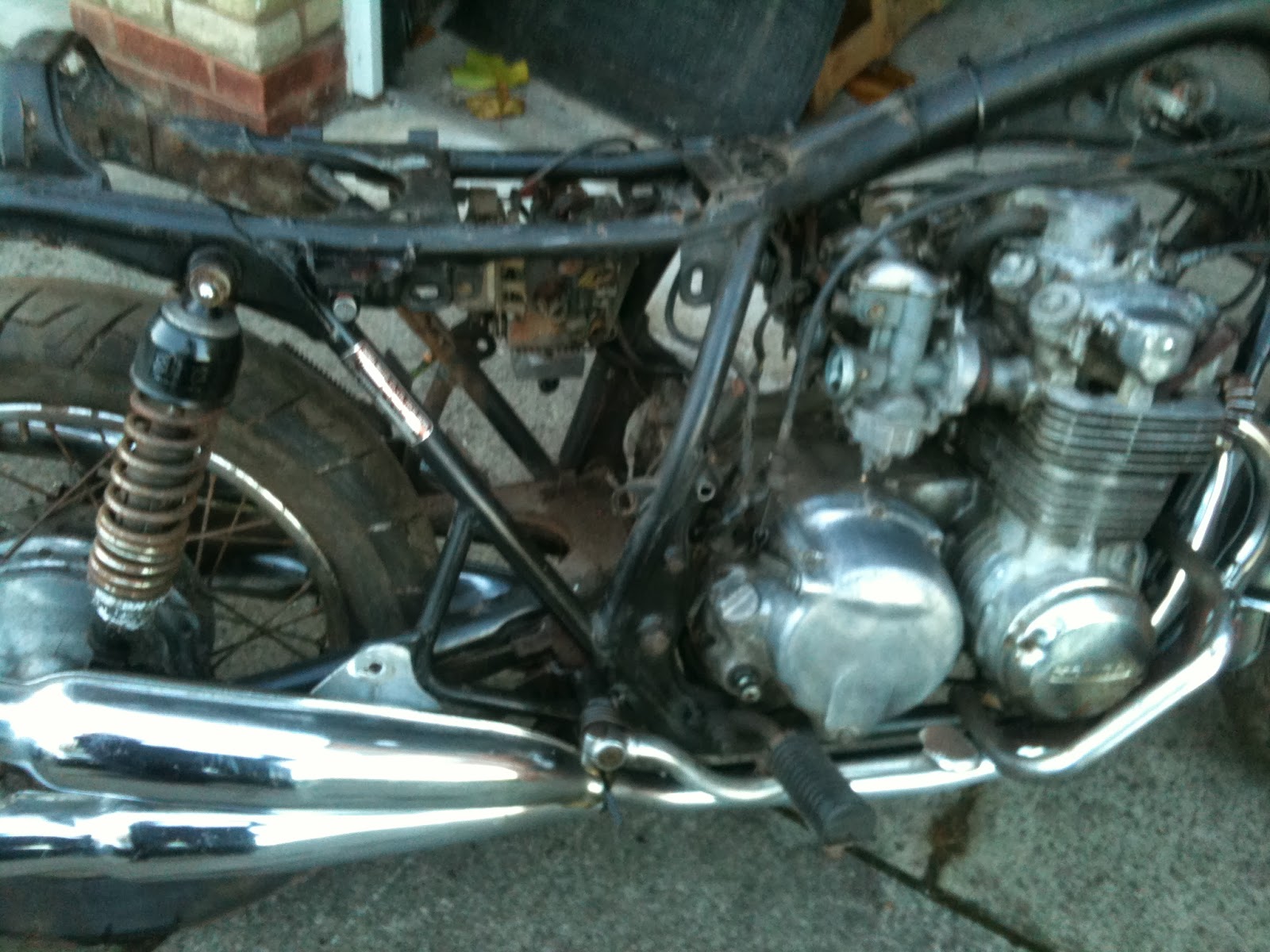

Had a good 1/2 day work on the CB550
decided to run it up 1st as I bought it unseen, fuelled up the carbs & jump leads off my van, great stuff started 1st time ran clean & no smoke or nasty noises

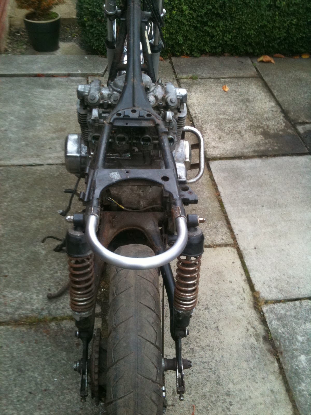

looks like the motor will be just a freshen up & paint, then on with the strip down, broke it down to a rolling chassis & cut the rear off the frame to fit the café hoop
I wanted a short rear end running say a 160 tyre (will this fit with new rim without fouling chain any one done it ??)
hoop finishes just forward from centre line of axle, mocked up a seat hump to see how it sits that's all for today keep you posted
its engine out & on with the grinder !! Sunday cheers all Andy

I don't think a 160 will fit the stock swing arm. Do a search of the forum, this is a popular topic

Rusty Olive fitted a 180 rear tire. But He had to fab up his own rear swing arm and used a 10 MM spacer on the rear sprocket. If your good with a welder, or know someone who is, go for it.

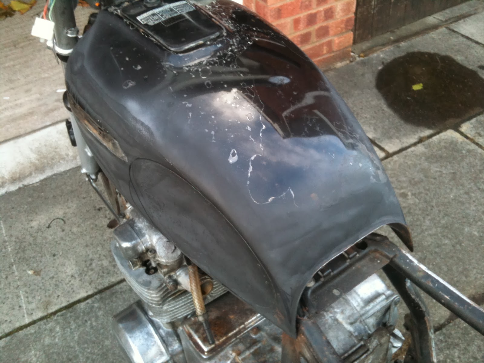

did some more deluging today I will finish it off properly when the motor is out
started the knee dents they are getting there
