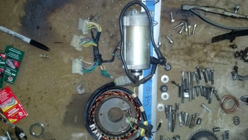

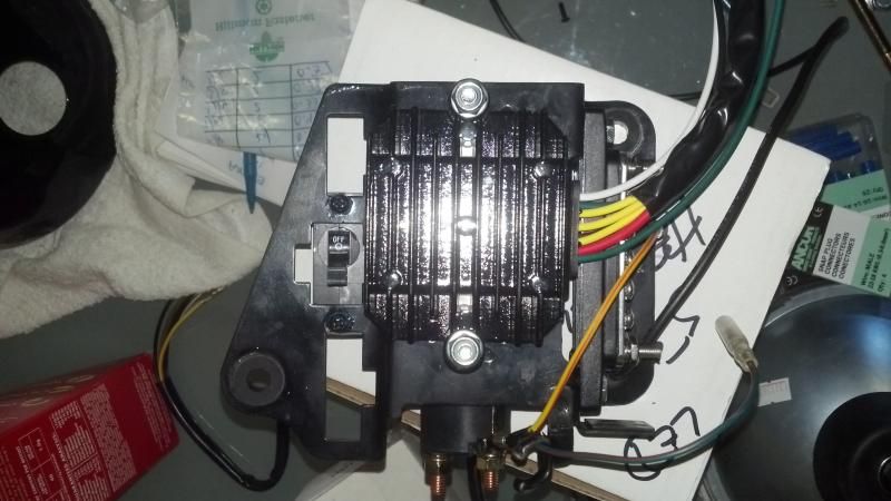

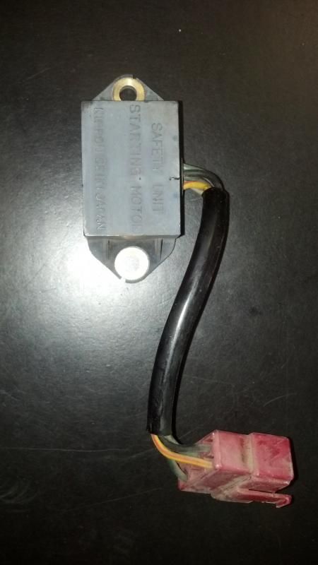

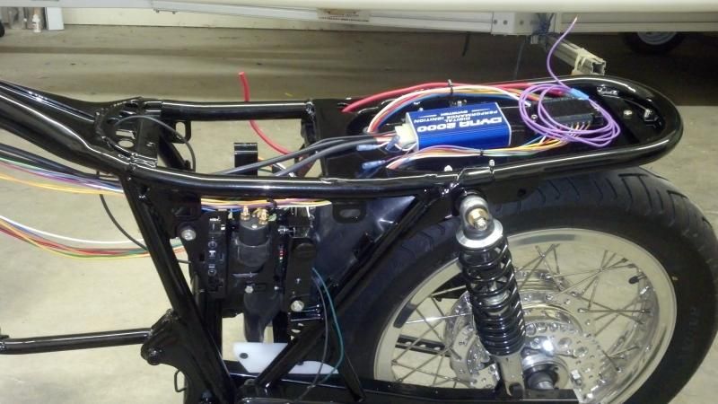

Wiring is in full swing.  Except for the starter safety unit (which Mr. Postman delivered this morning), I have everything I need mounted and wired on the left side electrics plate.  I used an OEM plate, blasted it, then cut off all mounts, etc which I do not need.  It was much easier than trying to fab up a new plate.  Now all I need to do is wire up the brake switches (not using a clutch switch), the neutral switch, connect the Dyna to the stator once the engine is back in the bike, and wire up the m-unit input wires to the 2 handlebar m-switches (5 push buttons total).  I also have a new Yuasa sealed battery with great cranking amperage (only slightly taller by 1/4" than OEM), and stator/field coil rewired by Rick's, rebuilt starter motor, and 2 new starter solenoids - also by Rick's.  Getting close - its making me crazy.

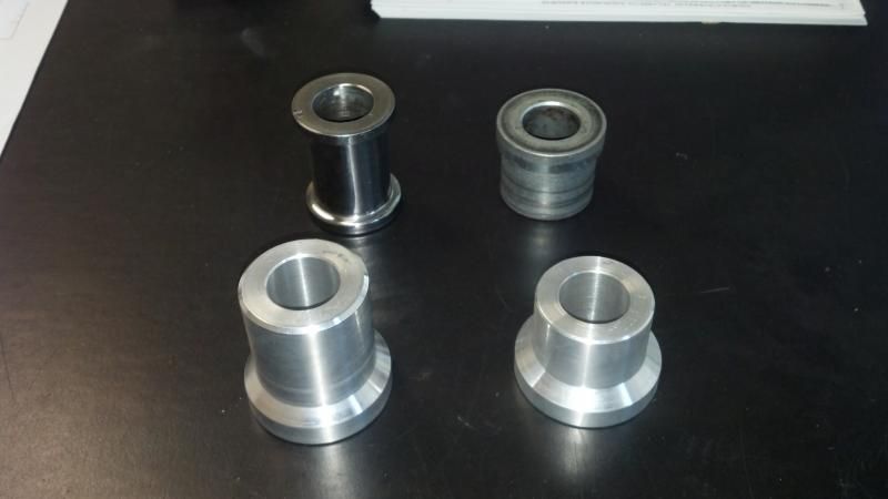

The new rear axle spacers arrived today (in the foreground).  They look even prettier in person.  Going to sneak away early to install. Another check off the list.

That is great to know!!  Yes - I am using the m-lock and one of the push buttons on the m-switch as the start/kill button.  Do you happen to need an OEM SMSU??  I was trying to discern from the directions as to whether the m-unit did, indeed, incorporate its own SSM/SMSU.  I swear I read those instructions (in English!) more than once trying to figure out if this is one of the m-unit's features.  That would be great to sh*t can the SMSU from my electrics plate.

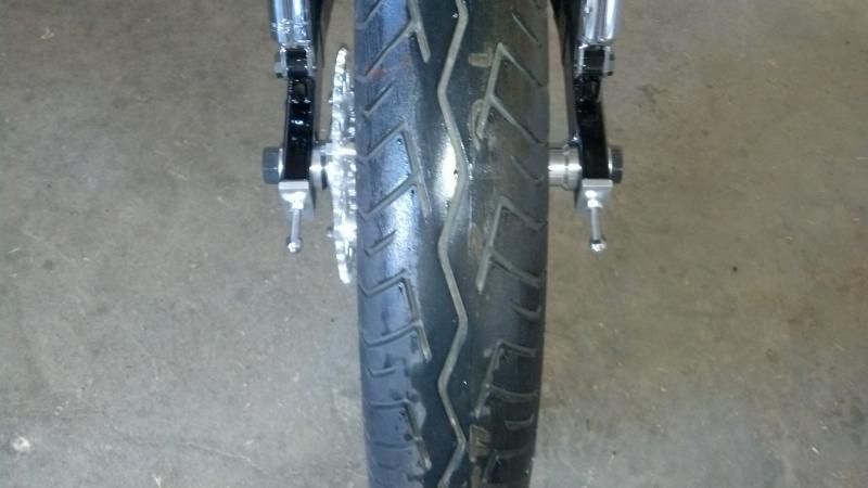

Rear tire looks even better with the new axle spacers.

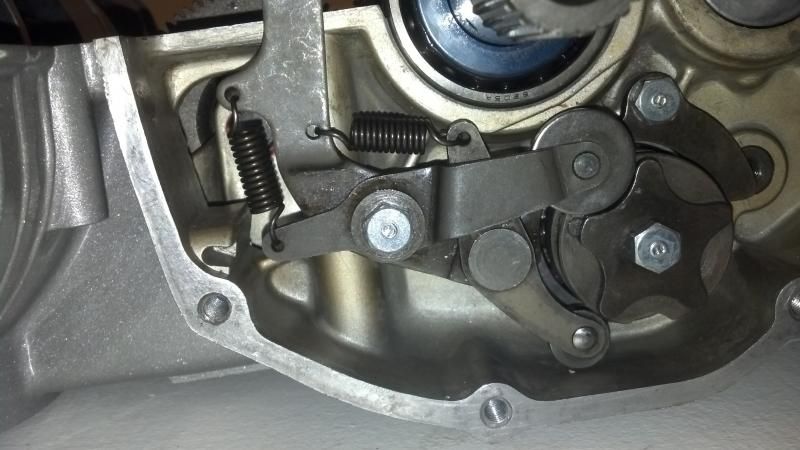

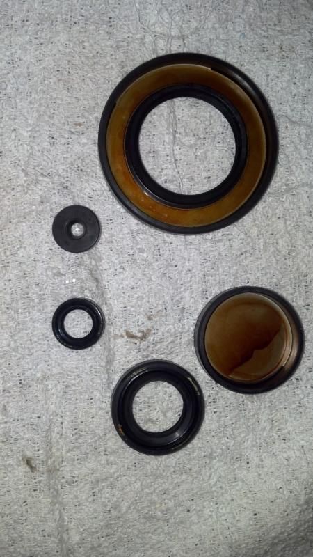

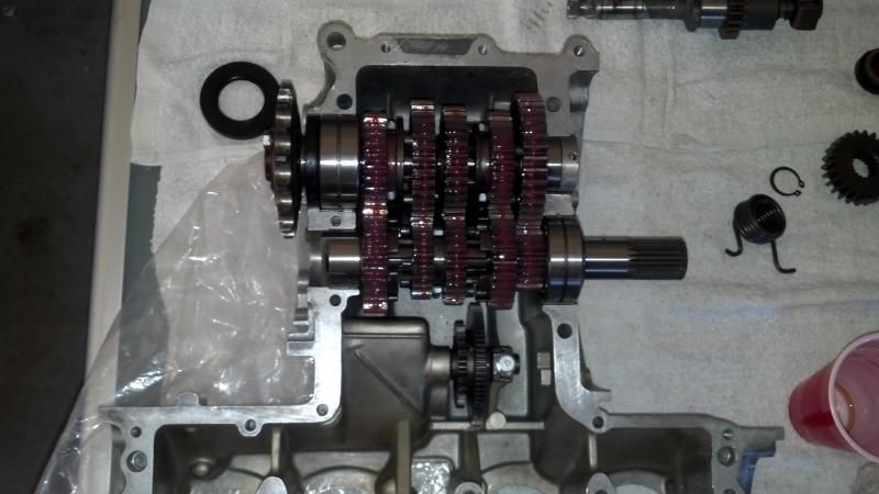

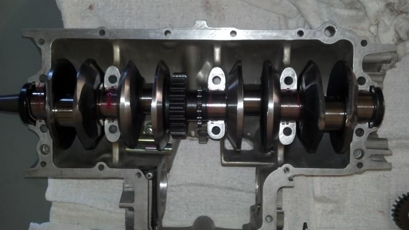

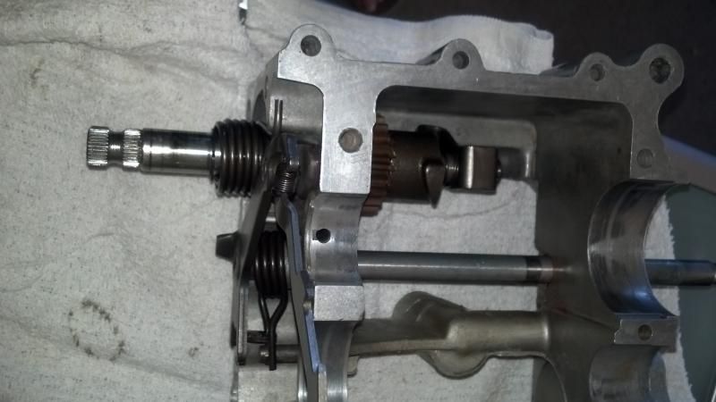

Reassembling cases.  If anyone sees something out of whack, please ley me know.  I'm am no engine builder - merely a follow the directions assembler.
Kick start shaft/mechanism.
Shift mechanism.
Lower case and crank.  The crank is just temporarily sitting in the lower case until I can source a new primary and cam chains.  Any suggestions as to where to look?
Tranny.
Some of the new oil seals.  Can anyone identify for me the 2 smallest seals and where they go?  I don't have the old ones and can't recall these.  I'm lost - even went to all the schematics for the 550 engine with no luck.

The small rings I believe are for the shifter seal and the neutral switch area... let me snap a pic to be sure of mine.

There you go.... If that isn't the correct ones I will take a look after I'm done frying the zucchini and squash!

Can't quite see the size of the seals, but if they aren't the ones Tews already suggested, they might possibly be the clutch arm dust seal (on the clutch cover) or the tach drive seal. I crossed referenced the sizes with CMSNL drawings.

Thanks Tews.  I have the shift drum shaft oil seal already installed - yes its the one immediately adjacent to the neutral switch.  Those 2 oil seals I am trying to figure out are much smaller than the shift drum shaft oil seal.

Of those two smaller seals, the one with the smaller inner diameter looks like it could be the tachometer drive seal, where the tach cable connects into the head.
The other seals appears like it could be the clutch actuating arm dust oil seal, this should be on the actual clutch cover, on the arm that the clutch cable connects to.
These drawings are for a '75 CB550 K, think these should be the same though....
Tach seal #35   http://www.cmsnl.com/honda-cb550k0-four-1975-usa_model465/partslist/E++01.html#results
Clutch arm #33http://www.cmsnl.com/honda-cb550k0-four-1975-usa_model465/partslist/E++03.html#results]

Bingo!  Thanks guys - you're the best!  You were exactly right.

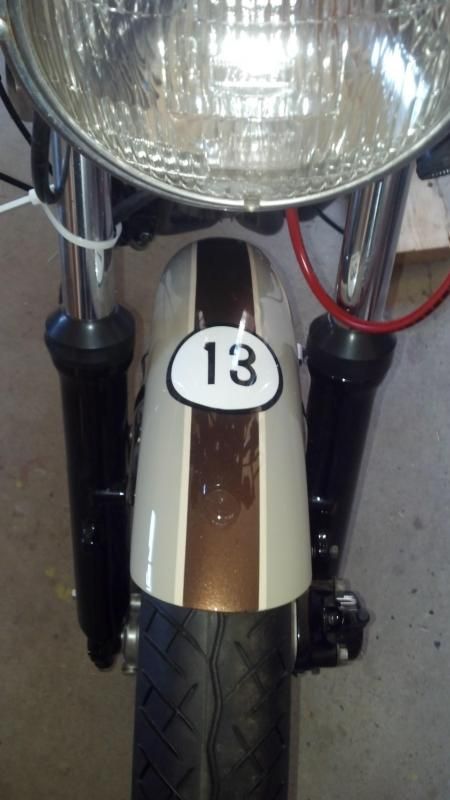

One of the reasons (but not the only) why this Danielle build is taking so long is that I tend to help my buddies with their 550s before working on mine.  Of the four other 550s, they are all coming to completion at about the same time.  This one is basically done as soon as the seat is mounted and taillight wired up.
Here are his "Brown Bomber" fender and seat just completed.

That paintwork and upholstery look great.
