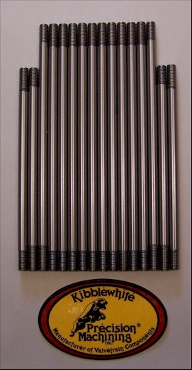

4 yrs. ago I bought 16 APE "heavy duty" cylinder studs from a reputable dealer we all know. I installed them back then and had one stud snap off under the nut during the torque sequence before I reached the set torque. The reputable dealer was nice enough to send a replacement. Changed it out and ran the motor for 500 miles before this happened:
After I catastrophically went kaput on the highway, I pulled the valve cover and found the tip of the stud laying next to the valve spring with no nut in sight. (see first pic)  I found the nut in the case bottom all chewed up.
I called APE for a replacement stud and when it got here I noticed the thread length was different than my others. I pulled the rest out of the case to scrape the gasket and double check those as well and found another one of my original ones was also threaded short.
The first one is the newest (uninstalled) replacement stud.
The second one is one of the original ones but the only one of the group not threaded the same.
The 3rd one is the one that caused all my woes. And you can see that the first 2 are not even threaded the same in comparison to the rest.
I called APE and they, rather testily,  insisted that they have been cutting studs the same way from the same specs for 35 years.
Needless to say, the reputable seller that I bought them from no longer sells APE stud for "quality control" issues. Given all the other APE "issues" I've read about on other boards, I'm fairly certain the reputable seller is the more believable one in all this.
Moral of the story: Be cautious of APE studs. Your mileage may vary.

geez id be really pissed off and sending those pics to an attorney.  not for sure what exactly, but id definitely be talkin to one.  thats ugly, and could have been way uglier
And over those 35 years, there are many stories of their studs breaking. Even when properly torqued. They roll the threads AFTER heat treat and the hardened material is developing micro cracks. A thread is rolled on a diameter pretty close to the pitch diameter of the thread. The rolling process pushes the root diameter in and causes the displaced material to flow up to the major diameter. Could be caused by "trash" on the rolling head but I think they should be rolled BEFORE heat treat while the material is more malleable. IMHO. We roll many threads in our shop to Customers' specifications. They all specify rolling threads prior to heat treat on high tensile strength material.

Does anyone have any APE studs laying around that they could measure the overall length of the threads on both ends for me? The more I read and the more I think about it, the more I wanna push this a little harder at APE HQ.

If someone says they had a stud fail, we simply send them replacements without asking for proof that they were ours. We are not the only one making these.
We sent this guy a replacement and it did not match what he had. We have made ours the same since the 70s.  Not sure what the guy had.

Jay is a member here and is good to stand by his products. What kmb69 descibes about rolling the thread first before hardening makes sense to me. I have heard of actual Ape studs breaking, although I haven't had the problem. I wonder what process APE uses.

Even if they weren't ours, but the guy thought it was, we don't care, we send him a replacement anyway. We have had people over tighten ours and pop the top off in the past, so we just take care of the guy.

Thanks Frank, No. I don't want to be in the cylinder stud business. And I didn't really mean to be baggin on Jay. It's just that you frequently read about somebody breaking an "APE" stud. maybe they are and maybe they aren't. I have used them without any mishap. If you are not there to do clinical failure analysis, it's hard to identify the root cause. Maybe the "Torquer" did not apply oil to the threads. Maybe the "Torquer's" wrench needs calibration. Maybe it's a defective part. Jay has probably sold tens or even hundreds of thousands of his studs. Kind of like the 50% divorce rate that gets to be 100% if it's you.
Always try to help.
That's standing behind your stuff right there! Hats off to Jay! He also openly publishes his process on his website:
"Heavy duty cylinder studs are necessary to prevent head gasket leakage in high compression and turbocharged engines. Stock studs are made from poor material that will stretch and allow gasket leakage. APE studs are made from heat treated chrome moly, centerless ground, and have rolled threads after heat treat for maximum strength. APE originated heavy duty studs for performance motorcycles and today is recognized as the industry's leading manufacturer. We supply studs to all of the top engine builders. No matter whose parts you have in your engine, join the top names in racing and insist on APE studs to hold it all together."
Heat treating after thread rolling would definitely drive the cost up as they would need to be heat treated in a vacumn and back filled with gas to prevent oxidation. Most of the threads we roll prior to heat treat are on tooling parts made from VascoMax 300 and stainless orthopedic medical devices where failure is not an option. Maybe the chrome moly is a different animal.

ya know what... after writing a long diatribe and then doing a lot of searching and thinking on this... I think I'm gonna back away from it and apologize to APE at this point. I bought the studs over 4 years ago and I can't prove or say with 100% certainty that they were APE studs even though they were billed a "HD Studs" and my memory says they were but, I've bought a lot of #$%* in the last 4 years and could very easily be transposing memories.
So I'm just gonna say #$%* it and chalk it up to a head scratching learning experience and drive on.
Big Jay/APE - my apologies for disparaging your studs. I would have sworn they were your studs, but after doing more research I can't say I'm as sure as I was 2 days ago.

I broke one APE HD stud in the same manner as yours. Stud snapped just under the nut. Torque was just before 22 ft lbs if I remember correctly. That specific stud felt different earlier during the torquing process, a soft feeling.
My old std OEM studs never close to snap despite 21 ft lbs in torque which I had done to them several times, 6 times if I remember all head off.
My package bought on eBay in the std package as everywhere else. I bought a new package here at my local dealer. Next time torqued up to 18 then almost 20, let it wait over night. Next day 20 hours later I re-torqued each nut one by one by release 1/4 turn and torqued to almost 20 ft lbs.
I regret that I did not replace all when I bought a new complete package when one snapped.

Well, I broke down and bought a new set of APE studs - still in APE packaging and everything - and they do in fact look different than the ones that started all this that I bought from the "reputable" seller. So who knows... we'll see if these do the trick.
