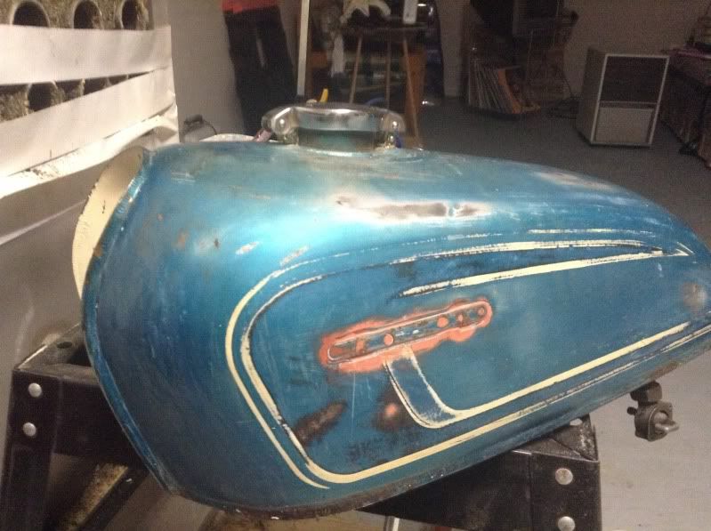

Just finished notching the frame to fit the back of the cl450 tank. Now it looks like the petcock will hit my carb.
Looking for the simplest solution, I'm thinking blocking this off and welding a new bung. Have a mig but don't trust myself doing this, tank is dry/rusty inside.

You can get inline petcock and filters at ace hardware in their mower section. I always thought about plugging a 450 and using the equalizer tubes.  Might have problems when low on fuel.
Does that one have a filler on the side or in the middle?  It looks like it's not all beat to heck.

The filler cap is in the middle but yeah the tank is a 10 footer but not too bad at all for a 40 year old tank. This is off a 72-74? Cl450.
I'm still looking for decent shape pre 71 as the tank doesn't have an oval shape.
So easiest/cheapest solution is to run inline petcock but best solution would be relocate to retain reserve function.

Swapped to a earlier cl450 tank. Less of an oval shape and colour/original patina gives the bike a nice look.
Bung is is m16 x 1.5, still working on getting it to work since the barb doesn't clear the carbs either. Having a hard time trying to get my hands on an elbow. That would clear for sure.
