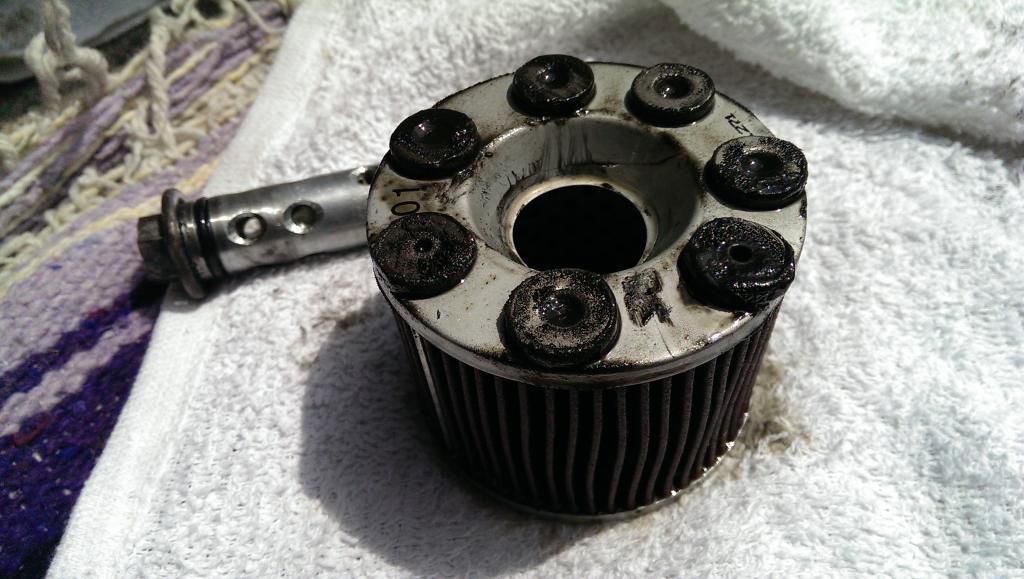

« Reply #11 on: February 10, 2015, 06:53:54 AM »
On a fresh rebuild (hone and re-ring)  Yes, i know there is no o-ring on this side of the filter.
This pic was after 50mi ring break-in ride.
Magnets looked the same at the 250mi oil change.
« Last Edit: February 10, 2015, 06:56:36 AM by flybox1 »
Looks lovely. haha.
Did you drop and clean your pan after the break in was done complete? I'd like to see what was at the bottom.  :P

@Trad
Removed the pan at the 250 mi change, had a same sediment, but much less.
Removed pan once more when i pulled the engine for a trans issue.
Little to no sediment.
