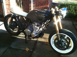

Hello all,
I'm Devin from Cognito Moto. I've been posting my builds DTT but frequent SOHC4 often to check out the builds so I figured I'd start sharing my builds.
I'm currently working on a CB750 for myself. I plan to make it a 2 up so my wife can come along for a ride here and there.
A few months back I picked up this CB750 frame and motor because it was a good deal.
I will need to rebuild the top half of motor. Has a leaking valve seal.
Found these forks on eBay for $220 shipped. I didn't have a build going on at the time but it was a steal so I bought them.
This is a gas tank I bought for my 550 build but didn't use it so ill use it on this one.
Little mock up
Found this 17 x 4.5" rim on eBay for $100. I like to run modern sport bike tires so this will fit a 160-17

Borrowed the wheels from my CB550 since I was waiting for more hubs to come in. Trying to layout the stance. These rims are 17's from a harley.
I used 14.3" shocks I had in stock for the rear.

Since I am basically almost copying what you did with the 550, what size/type of rims and tires you use?
Are you going to use the same/similar for the 750?
since you are doing a rear 17" wheel, what size/type you are using for the front?

The front has a 17x2.75" harley rim with a 110/70/17 tire. If you can find a 17x3.5" tire you can use the more common 120/70/17 tire.
The rear is a 160/60/17 tire on a 17x4.5" harley rim.
The cb550 has a wider swingarm so this works. The stamped sheetmetal swingarm on the 750 is a bit more narrow and you will need to run a 150 tire. I have not tested this so I maybe wrong.
You will need 10mm offset sprockets front and rear. You will need to figure out the brake anti pivot arm and brake pull lever.

Great work on all the custom parts. I followed your 550 thread on DTT... Is the price still the same for the hub? I forget, how do you decide on a rim with your hub? Will a stock Honda rim work? Or custom?
1970 Honda CB750 survivor.
Offline CognitoMoto
  • Posts: 135
  • Cognito Moto
    • CognitoMoto
Re: Cognito Moto CB750 cafe with GSX-R forks
« Reply #24 on: November 22, 2013, 07:48:27 PM »
Pricing is still the same. I have it listed on the site. The hub is 40 hole so that you can use stock rims as well. I have 36 holes as well but they are still in production.
http://cognitomoto.com/collections/gsxr-conversion-parts/products/gsx-r-hub-bolt-on-conversion-laced-wheel
