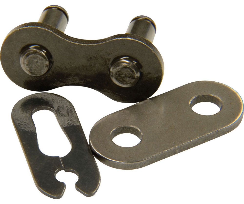

And the love affair begins...
On the bright side it did shift smoothly up to the point I had to push it home
First part ordered!
