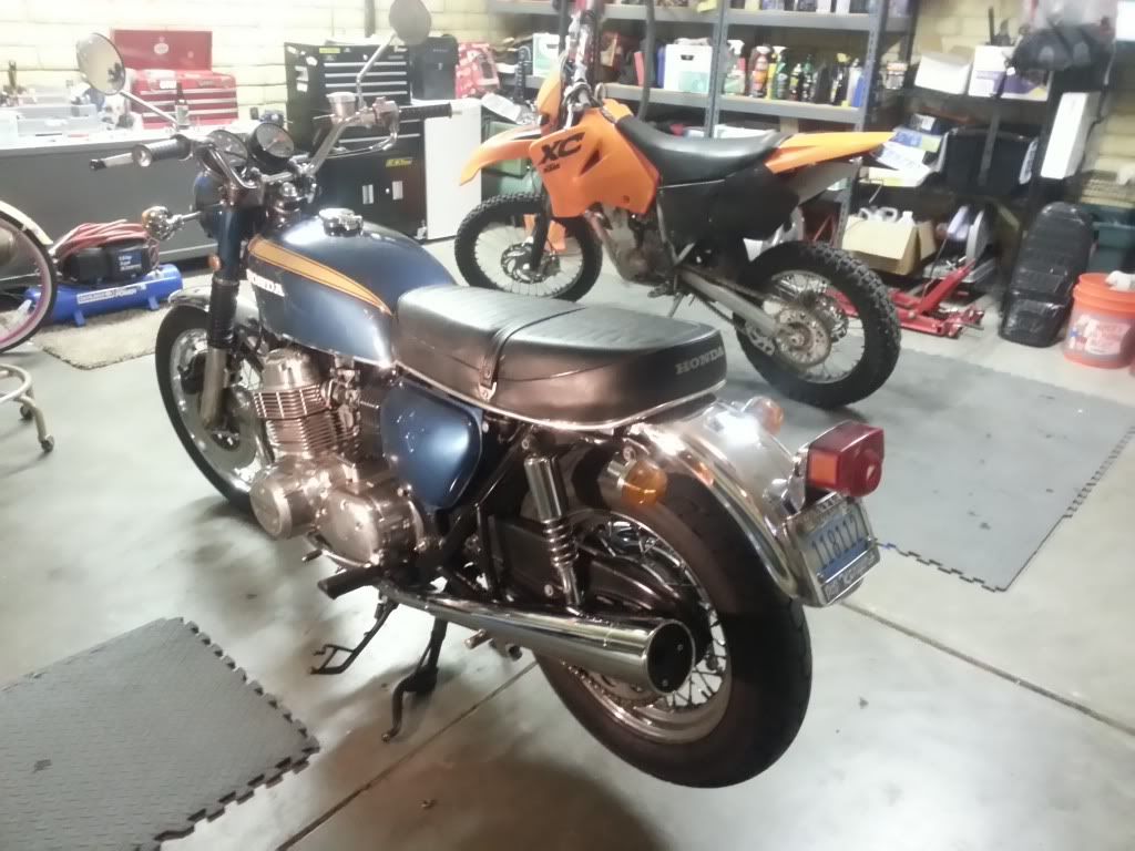

Here's another couple of shots, they use the original headers which were already cut for the last set of low rider slip-ons I had, they have a nice upswept look, and they sound OK, Im just missing the rumble.
Maybe Ill drill out the rivets and see what I can see, worst case Ill replace the rivets and button them back up.

They fit very well with a little chopping on the header pipes. I mounted the mufflers and the slid each head pipe on and marked them with a sharpie, chopped em and hit with my grinding wheel, fit right up no issues. Price is pretty good and the chrome quality is very good.
