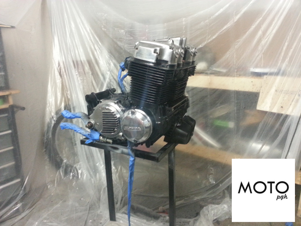

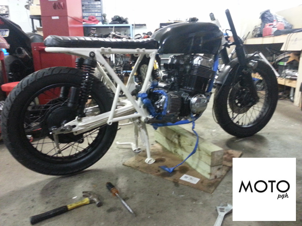

Completed:
Motor Rebuilt, Bored out to 915cc using the wiesco 915cc pistons, new performance cam shafts, all bolts replaced w/ allen bolts and all gaskets replaced.
Frame powder coated white and tail loop welded on.
Clip - Ons to replace stock bars
Replaced stock headlight
made a custom brat style seat
Tank repainted
Replaced clutch and throttle cables
New 4 into 1 exhaust
To Dos:
New Carbs 4 into 2 set up
Install wiring (chopper wire)
