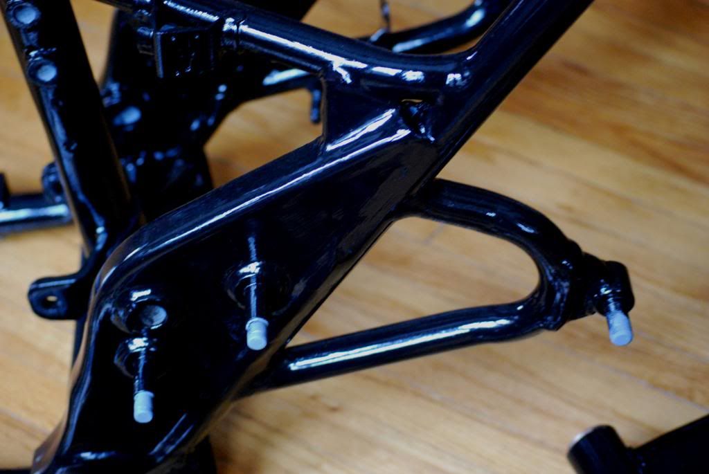

I'll try to attach a couple of pictures, one of the type of bracket that I'm talking about, and the second with the frame identification plate.

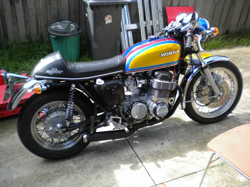

I used the Por 15 Hardnose and was happy with it.  You can brush it on or spray it.  It is a two part catalyzed paint so it is toxic so you have to use a respirator.  Brushing is safer but it still has some nasty fumes so you need good ventilation.  It lays down nice and the brush marks flow out to a nice high gloss finish...probably more glossy than the original paint.  Brushing was much slower and tedious but I had no choice....it was winter and I had to do it in the porch...heaters on and a window open for ventilation....and well sealed form the rest of the house.    On this XS650 frame I used a small amount of JB Weld as putty to fair out around the ugly welds and did a small amount of filing to knock down any high spots and welding splatter.

Thanks for the advice, srust58, your frame looks fantastic. I will probably follow your example and as jamesb says, have plenty of patience.
Beautiful job!  I like the way you feathered out around the welds to make everything flows smoothly. The transitions between the welded parts are less abrupt.
I did that anywhere there was a visible weld...amazing how little was needed and the frame does look much better.  From what a few others have said the JB will hold up to powercoating too so why go to all the work to get a nice paint or PC job and have all those ugly welds?

Here are some pics of my frame and other small pieces done by a powder coater in Sydney. The frame was grit blasted then powder coated gloss black. I hosed it down at home to get the crud off from his shop after picking it up. I'm real happy with the results & will probably do it again on my next frame by the same bloke.
Last two pictures is the gauges before and after.
PS: Also attached is the Rust Gaurd epoxy enamel (same/simliar to the Killrust that both Terry and Dave were talking about). Its great stuff, you'll love it.
