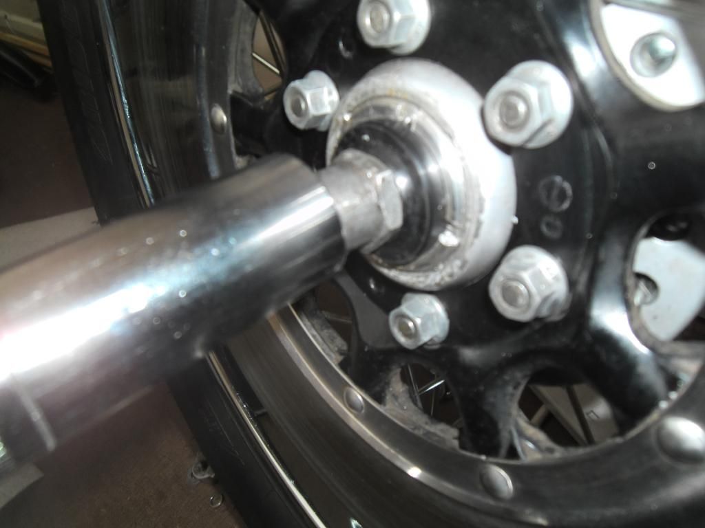

Trying to work this out how do you torque up the front wheel nut ( have the extra deep socket )  without the whole axle turning, wheel is off the bike
Hole in other end about 2mm deep?
Thanks guys

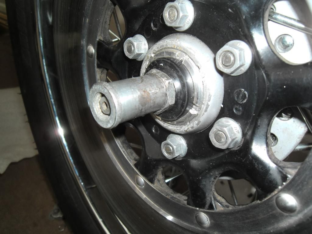

the hole on the other side of spindle?
that is about 2mm deep, is it meant to be fairly deep hole

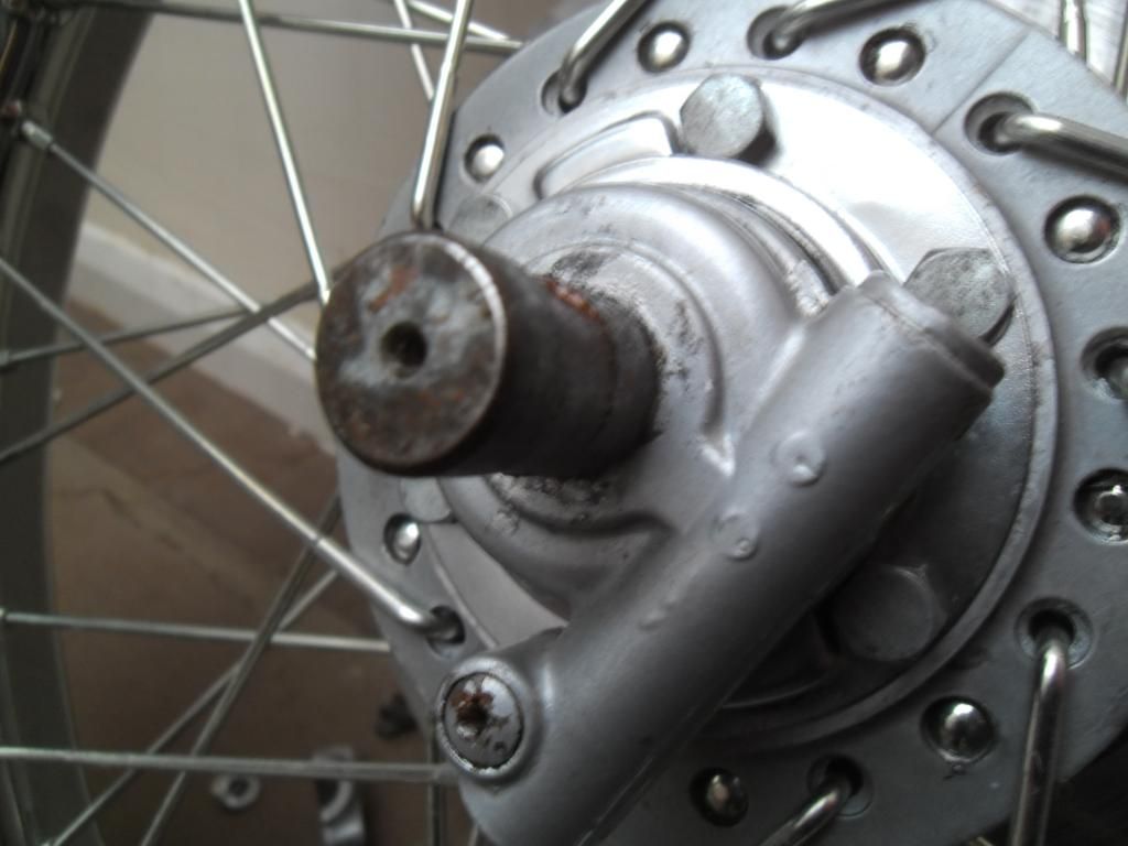

Re: newbie front wheel nut question
« Reply #2 on: January 17, 2014, 06:58:43 AM »
this hole
Offline MIKE550/4
  • Posts: 55
« Reply #3 on: January 17, 2014, 07:47:24 AM »
no hole there mate  :-\
« Reply #4 on: January 17, 2014, 07:51:32 AM »
my 350F had a hole there, and yours looked like it had one, too.
BUT,there ARE two flat sides on that end.
A box wrench there, and another on the other end where the socket wouldn't fit, and you're good.
