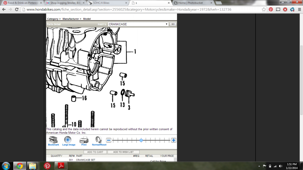

So oil is suppose to pass between the crankcase and the alternator cover...so essentially taking off the cover will spill some oil.  The parts diagram shows a round plug with a point..all I see is a flat plug

i see the indent on the cover that is supposedly keeping the plug in, but there is no way that the plug is kept in by the cover.  The plug came out half way no way near the outer edge of the crankcase and oil was spilling out ......NUMBER 3...this would keep it in,,,,, do i have it in backwards?? dont remember taking it out

OK, I see the point now. Looks familiar, too. I don't have an engine open to look at right now... but if the thing didn't spew oil through the alternator previously, something sure as heck held that plug in. Does it look like that point broke off? Did some weird part a PO stuffed in there (to hold the plug in) fall out and get lost? You say halfway out... any chance it's in there backwards?
