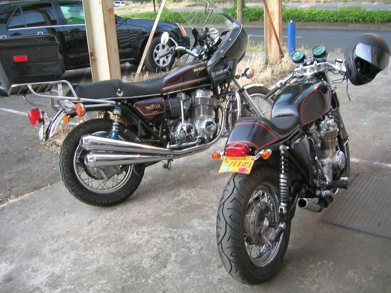

Offline paulages
  • Posts: 3,875
  • 1976 cb735
    • DOOMTOWN RIDERS P.R.M.C.
Re: experiment: hammering a new shape to an old CB750 gas tank
« Reply #17 on: September 17, 2006, 12:29:52 PM »
that's not my 750...but this one is:
paul

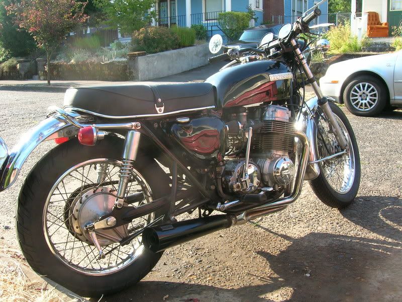

Offline fang
  • Posts: 401
    • Food Renegade
« Reply #20 on: February 10, 2010, 12:17:52 AM »
It looks like you guys have done some fine work.
How about a few updated pics of my old project?  This is the same rough old tank from the first pics.  These pieces sat around for a few years, but then, all of a sudden, I needed a gas tank.  So I pulled them off the shelf and have been working on them off and on over the last few months.  I shot the paint, and I think I took these pictures early last week:
I had just painted the pieces the night before and wanted to roll them out into the late after-morning winter sunshine to take a better peek at my handiwork.  I painted the side covers, headlight bucket and the tank.  They are all a bit rough, but some wet 1000-1500-2000 will get them ready for a final shot of clear.   Shooting paint in the home workshop guarantee's quite a bit of dust/lint in the paint.  But like I said, all that will buff out, and combined with some hard work on the other bits, the finished product will be more show-stopping fantastic. <wink,wink>
That is an old leather seat cover I made ages ago.  I just recently removed and restitched the piping along the main seam, and still need to build up the foam and remount it.  You can see one of my daily drivers there in the background.  It is a '75 RD350 that I have been tinkering with.  The tank is off a 1960's Yamaha YCS-something.  I had to cut and stretch it to make it fit, and the whole bike supposedly will look an awful lot like a nice little 1960's 180cc scooter when I am done.  But I have a ton of engine work dumped into it, and it actually is quicker than a stock CB750.  Quite a bit quicker....   (Which is a funny thing to say, because if you look closely you will notice the motor is 1/2 out of the machine right now.)
A nice clear, cold day.   And, YES.  I chose the aftermarket bolt-on ABS side covers because (1) I did not want emblems, and (2) I have a lot of time and love dumped into making these things shiny.  When I am done, I don't want the covers to blow off, which has happened to me one or two times in the past!  No apologies -- I prefer the ABS bolt-on style!
One angle of the tank.  The clip on handlebars actually fit the cutouts; when up against the tank, their angle more or less matches the shape of the indentions.  If you squint, you can see I left one emblem mounting hole on each side and I have some nice old round emblems which I just hand repainted to match the tank.  All the radii of the curves actually match the radius of the emblem -- if you look carefully, all the major bends on each of the pieces share the same arcing curve; the same radius to their bends, and I am hoping that when the emblems are there it will help tie together that little bit of symmetry....
Another view of the tank.
All in all, it is coming together.  Nothing is perfect, but nothing looks too shabby either.  Imagine one of those 900cc motors stuffed in there and a nice, happy, shiny machine to go with it.  That's enough to put a real smile on my ugly mug.
I will probably start a new thread in a few weeks when the progress comes together a little better.  I just thought I'd post a few pics to help keep me motivated.
Peace and grease.
-fang

Offline jtsmith
  • Posts: 40
« Reply #23 on: February 10, 2010, 10:19:02 AM »
Fang,
Maybe I missed it, but I didn't see which way you decided to fill in, bondo, resin, or silver solder?
That tank looks freakin' awesome, and would love to know how you got such smooth lines.
Cheers,
JT
1975 CB750K
Offline grumpy
  • Posts: 1,358
  • ..... '73 750K3 .....
« Reply #24 on: February 10, 2010, 12:29:49 PM »
That's COOL!
Where'd you get the ABS side covers??
