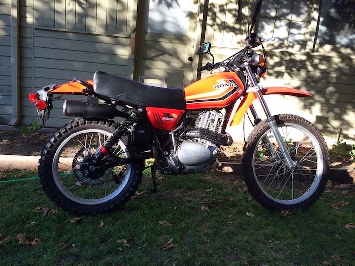

I picked this up the other day, and it's in crazy nice condition with a ton of new parts by the P.O. The only thing I am having to sort out are some electrical issues, as the 6v systems on these particular bikes are really fussy. My intention in buying a dual sport was so that I could actually take it offroad onto the trails and dirt...but this thing is so nice I'm tempted to not take it offroad at all! Which is a dilemma, of course....since that means I either sell it and get one that I can take offroad and not worry about it, or keep it and get another dual sport. This is complicated by the fact that I want to get another CB550 or maybe even a CB350 to fix up as my street bike. Not enough room or funds to keep more than two bikes! Ah, decisions, decisions....

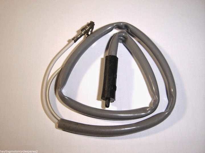

First, the front brake light switch was broken. This is the switch that works off of the handlebar brake lever, and operates by a little spring loaded switch that closes the circuit when you pull the handle to apply the front brake, and opens the circuit when you let it go. Problem was the tiny little plastic stem that allows this to happen was broke off, so the brake light just stayed on all the time (switch constantly closed). I found a replacement on eBay, and it now works as it should. Here's a pic showing the small plastic stem that operates the spring loaded switch:

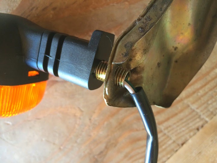

The main issue I had with installation was that the original holes in the metal plate under the plastic fender were not perfectly round, and were therefore not allowing the larger threaded stem of the new signals to slip through. Here's a shot of the oblong, irregular hole:
I ended up drilling it out a bit with a metal drill bit and filing the edges down just enough to let the new stems pass through. I dismantled the metal fender underframe from the rest of the fender before doing this so that I would not ruin any of the other parts or surfaces. Here's me testing new stem fit into the drilled hole...

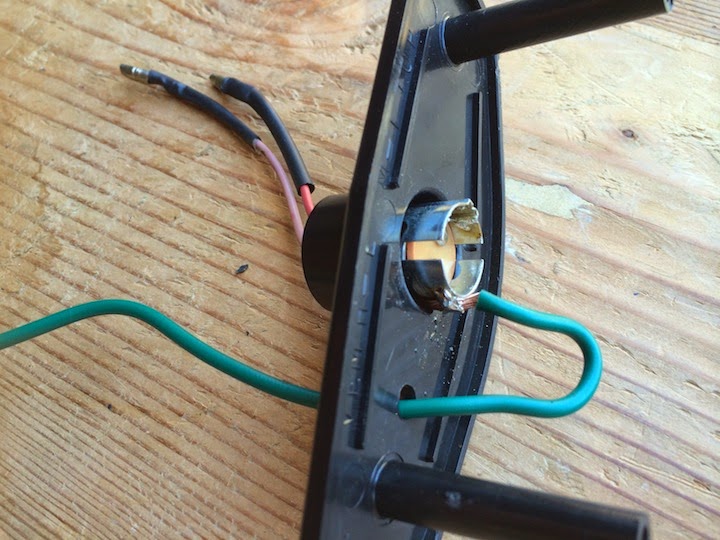

Next issue was that the brake light was still misbehaving, even after replacing the front switch and checking all the connections. A little investigation revealed that the ground wire going to the break light housing was loose where it connected to the base of the bulb casing. I ended up soldering it to the outside of the bulb sleeve and routing the ground wire back through the plastic base. Reconnected everything, and that did the trick!
